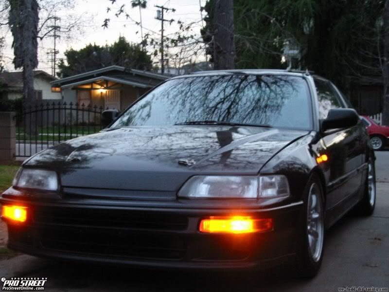

I've wired certain front lights on other cars (like my old Integra) to come on without the headlights like that, usually just a matter of providing a constant 12V to a wire to trick the lights into thinking that the headlights are on...but that's when they have a separate switch, these are just on the headlight multiswitch, so I dunno how hard it is. Search honda-tech, I'm sure someone has done it. Obviously they aren't nearly bright enough to do any good as foglights, it's purely for looks...but it does look cool. Just make sure you manage to wire it so your corner lights still function as turn signals.
2,605 Posts
The stock bulbs are 27 watts each IIRC. Fog lights are generally 55 watts each. Also, the light pattern from the turn signals is aimed too high to be useful as fog, or even driving lights. If you just want the marker-light look, dual filament sockets from newer Hondas seem to fit perfectly:
2,605 Posts
I used '97 Accord corner light sockets, actually. Like I said, they fit the CRX bumper housings perfectly (even the little lock/unlock arrows line up), but use a different electrical connector. I like this one better actually, it's smaller, easier to unplug and has actual seals instead of packed grease. As for wiring, the color codes were identical IIRC, except it gives you an extra red/blk wire that you tap into the corner light wiring. Anywhere you see a red/blk wire in the car, it's fused power from the parking lights contact of the lighting switch. Running the wire through the loom as it should be only means unwrapping a foot or two of harness.

In stock form, the side marker light (the rear-most light on the US corner light) alternates blinking with the bumper light. Are you saying to simply switch them around, so the bumper light stays on and the side marker is off most of the time? You might also consider just running the bumper light in paralel with the side marker, so they're both on or off at the same time (mostly on).
The potential problem I see with both of those is that the side marker relay (built into the integrated control unit) might not be designed to handle the additional 9+ times the wattage you would be drawing through it. Stock, the much higher wattage bumper light is driven directly by the flasher/signal switch, while the side marker has a relay to make it alternate when appropriate.
