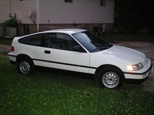

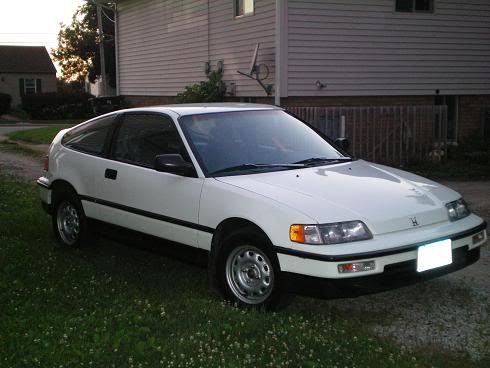

New to the forums but not CRXs, currently on #5 & 6. So I had a deal to buy a restored '91 Si with 50K but he backed out after agreeing to sell. I can't really blame him the car is awesome. Anyways I decided to start working on my '90 DX I bought almost 2 years ago(105K) but just never did anything until tonight. I took the first step by ordering a B16B complete changeover with all hasport mounts, linkage, axles, brackets & hyrdo conversion from hmotorsonline.com. Thx Steve, appreciate all the help answering my many questions & for the great service.
This forum has awesome info I'm using to help me plan the many, many things I have to look forward to do. I hope to help contribute any info I have along the way and here she sits at the start of her journey.
