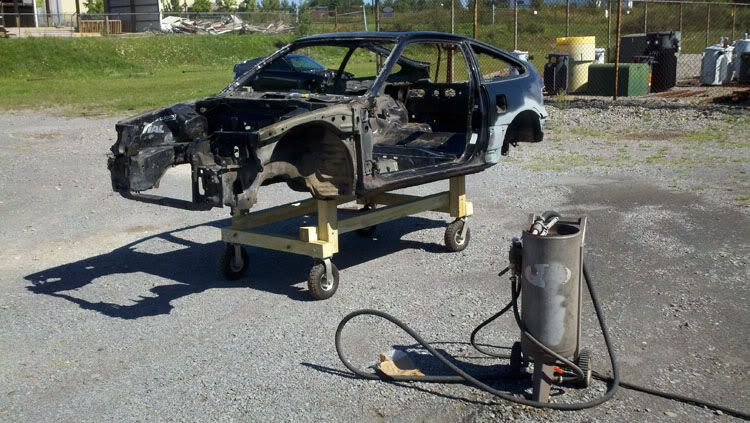

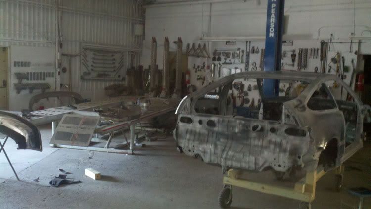

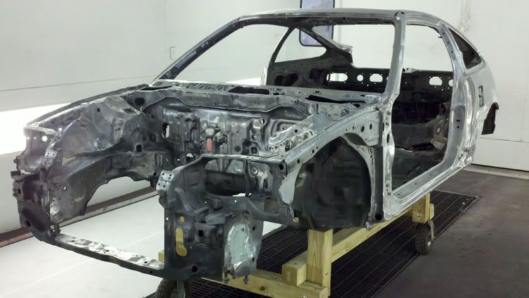

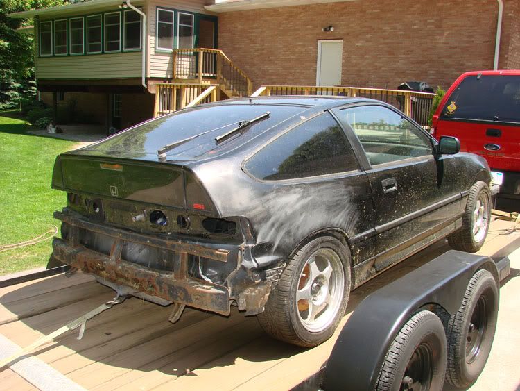

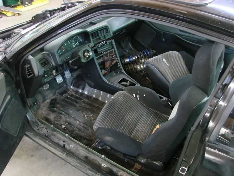

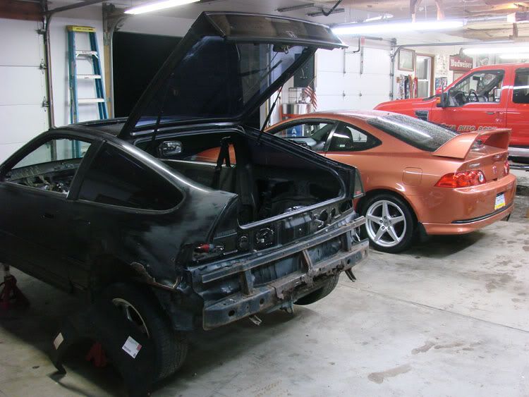

Well here is my 1990 CRX Si. I purchased it on May 29th 2010 and am working on giving it a complete restoration. It needs a lot, i have already completed a lot but there is still A LOT to do. This is my 2nd complete Honda rebuild but this one is much more in depth than my 92 CX Hatch which was a complete ricer. The CRX i want to be much more original and clean looking than the civic it will also be straight as an arrow. My plan is for it to be in my opinion completely flawless! I did most of the tear down work at home but i am doing all the suspension, body and paint work at my dads body shop. My expected completion time is around early summer next year... Since i can't just spawn money whenever necessary. Anyways here are some pics!
The Day She Arrived
Beginning of Tear down
Next to the RSX

Sandblasting
Sandblasted and getting ready for some corrosion protection
Corrosion Protection

Here's the progress since my last post (sorry about the crappy picture)... my little brother and i have spent the last 3days working on cleaning up the inside to get it prepped for sealer and paint... meanwhile my dad has been helping me out with straightening the quarter panels.
The color i chose was Honda R-519. It is a color honda had available in the early to mid 2000's maybe even before that. It was common on the S2K. We have books at work with every color put on every car since the 1980's and this red was the one that looked the best to me. It is a very red color, doesn't have an orange look to it like a lot of reds do. It is going to be base cleared on the outside with Sikkens Autowave MM water based base coat and cleared with Sikkens Autoclear III as well on the outside. For the inside and engine compartment i chose to use Dupont Industrial Imron which we had mixed in Honda R-519 so it will match the outside nearly perfect. It is much stronger and will hold up better than base clear in areas where there will be wear such as the floor and it is chemical resistant so it will work great under the hood.

Here is what i did this evening after work... got the inside all sealed up. Tomorrow the interior and engine compartment will be scuffed up and hopefully it will see some new seam sealer and lots of red paint this weekend!
