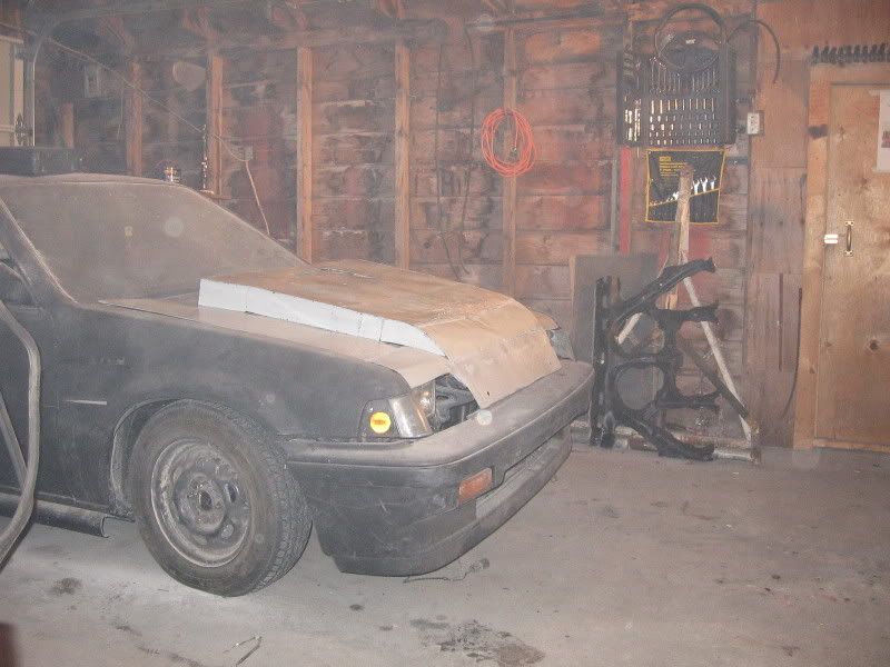

i saw that a member did a hood on his 2nd gen on here and loved it :)
so i did my own (will be done tomorow for sure)
first i did a one peice hood (know more plastic header panel ) :D
i thought i had a picof it finished ,but i guess not ,you couldent even tell it was done and was painted flate black
you can see i had some reall high and lows here ,so i got the bondo out of there and glassed instead
glassing starts tomorow
and just think if i wanna do a k swap or whatever ,no hood clearence issues lol

little hood update i glassed that sucker ;)

i thought i updated this huh oh well here is a pic of where im at now ive got most of the hood blocked down ,now i just have some squareing and low spots to deal with and it should be done
shes getting there hehe

allmost done ,few spots here and there and she is done , i really like how it looks not as big looking now i think all in one color
freakin cool :D and its not heavy at all ,i thought the glass would add some wiehgt ,but not really much at all
