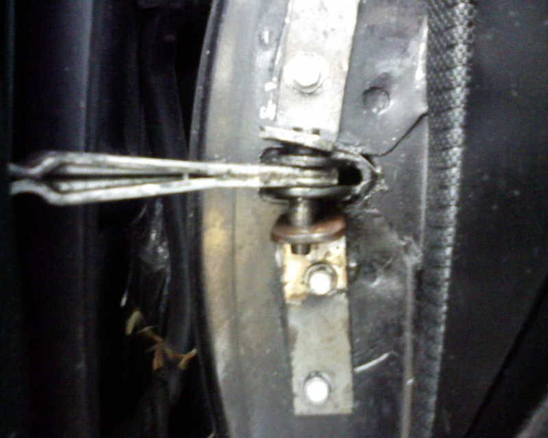

this hasnt happened when I bought my car, but now I've been noticing that everytime I open my door, it pops. Well you guys will get what im saying once you see the serious pictures.
half-way opened
all the way
yea so its pretty obvious why its making that sound. Could this be fixed, or should I just take it to a shop?[/img]

Looks like someone already half-assed it.
It can be fixed....but usually by a decent bodyshop.

my drivers side is also mega-messed up in that area. pretty much the worst part of my car. It was ghetto-welded and is cracked up and rusty in a couple square inch area.

Cost me $30 to repair mine at the local body shop. They even painted the weld yellow to match :)
I've never seen this before. I think you'd really have to push on the door with some force to get that to break loose like that. A couple welds should certainly fix it though.

The place I went said they see it all the time. The metal fatigues after time It's the reason so many cars have dents in the front quater panel...but yea I guess people are doing miami vice type door openings or something.

I don't think it's a problem from excessive force, it's a rust prone area.

that part is in the jam of the car itself ,it's not caused by rust just poor spot weld from the factory the only thing to do is have it welded ,i've seen this on cars with less than 50k on them and no rust
I think it also occurs when people try to over extend the door past the limit imposed by that check link. People swing the long, heavy crx doors open hard and it fatigues that little area very quickly.

Which part should be re-welded? My driver's side is doing that pretty bad, and I'm thinking that I could just lay a few quick beads and be done with it.
The part in question is called a "door check".
The part becomes loose because the small spot weld that holds the part to the unibody breaks free from the welds.
If your handy with a welder remove the pin and tack a few welds on the door check and your done.
