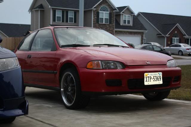

Whats up dudes and gals, here I am introducing my 92 Civic Hatch Dx I just recently adquired. Its stock, missing a few things here and there, such as Carpet, Rear speakers, floor mats, and good rims. It still has the D15b7 with a generic intake But the last owner sold it to me with a side B16A2 complete engine that thru out a rod main baring.
Just like all hondas that are not taken care like they are suppose to, it has some rust in (lucky me) one rear quarter, I still gotta clean it and finish inspecting it. For the price I paid, I think is worth it.

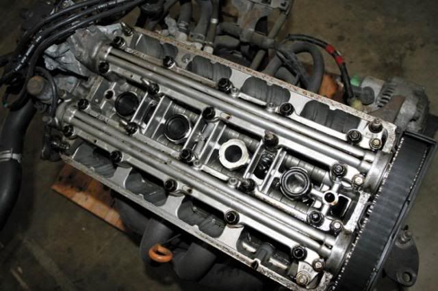

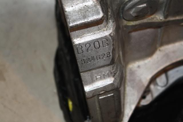

Mean while, I also landed in a great deal with a Complete B20B Block, $250 for this bad boy.
I am gonna clean and detail the hatch and daily drive it during the winter, I am gonna try to get all the necesary parts to get this B20/VTEC going and assemble it only when everything is in my shop.
So here is another build thread to look foward. Ohh yeah, I am not gonna make a 250 WHP NA, just a simple 190-200HP with some good old torque. :nod: :mrgreen: :)b

Here are some pictures of the hatch with the CRX Rims, and the rear view mirror installed
