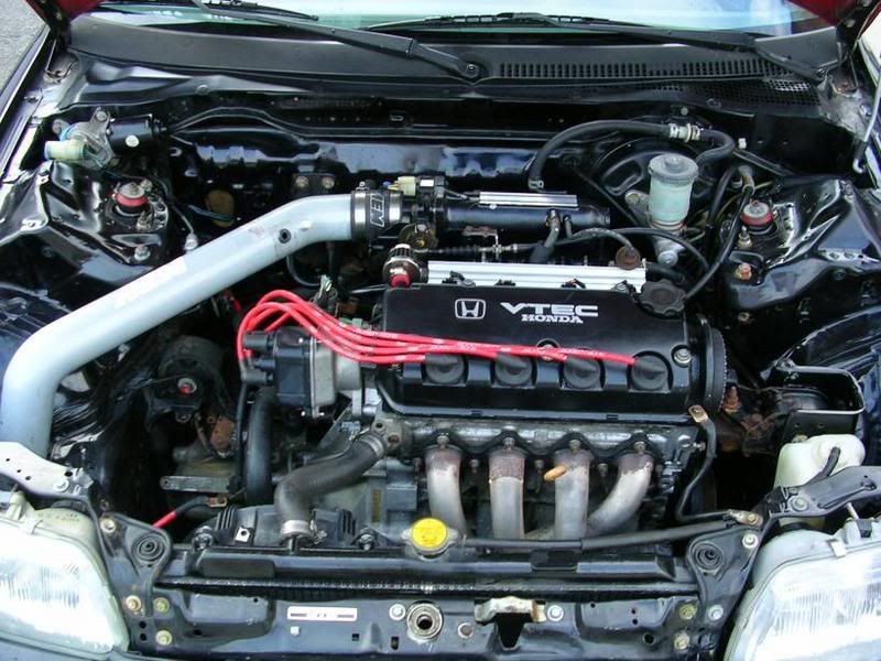

downest's A6/Y8 mini-me:
Note that the D16Z6, D16Y8, and D15B VTEC will look similar to the mini me.

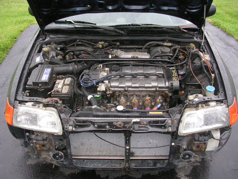

Baker's DOHC ZC:
