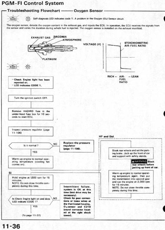

If it's just one blink, that's a code. CODE 1 is for improper oxygen content. In my manual, it says that this is either cause by the Fuel Pressure regulator, or a bad O2 sensor. Does anyone have a link for a service manual that he can refer to? There's a nice trouble shooting chart in the manual for this problem.
