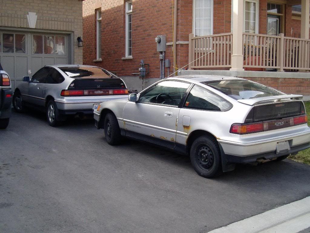

As of April 14th 2006 i became the proud owner of another Special Edition...
Here are the pics...
And here is something i wanted to ask someone who knew.

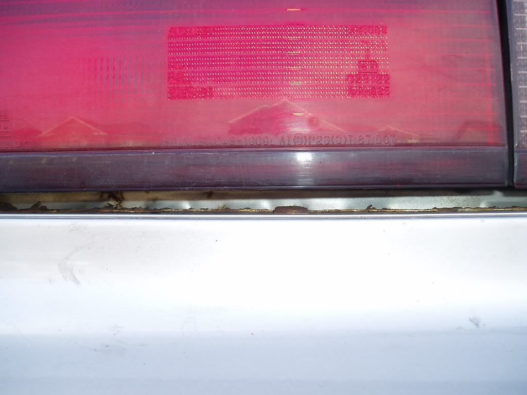

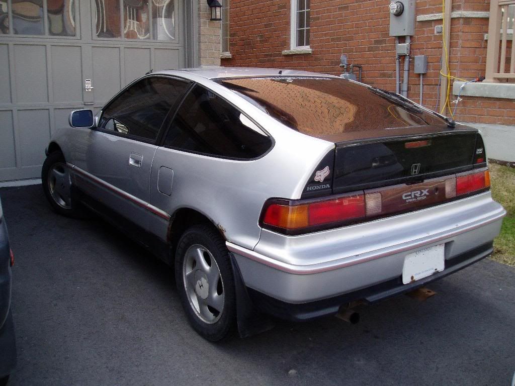

I noticed quite a large gap between the back bumper and the taillights (atleast 1 - 1.5 cm)
The car has a hitch on it. Can someone please tell me if this is a serious issue or not (please tell me my frame isn't bent?!?!?!)

your back bumper is prob. bent... or the small metal support that is on top of the back bumper is prob rusting out causing the back bumper to sag... i would pull the rear bumper cover off and then you should be able to see what the problem is.. .. . check for that rusted out top support and then try adjusting the bumper up at the mounting holes.... might have to slot the bumper holes to line it all up if something is bent. . .

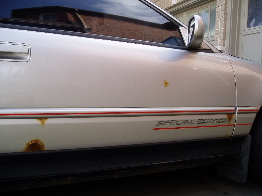

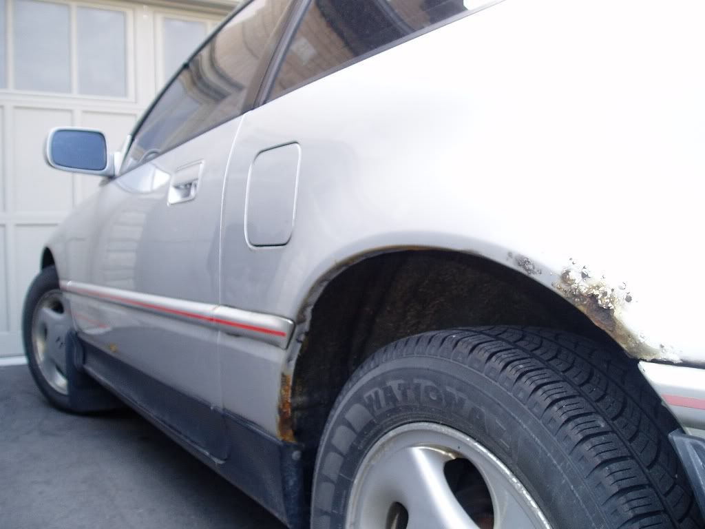

SETI: Oh yea, on the one i'm currently driving i will need to replace most of the paneling... But thats a later project ;).

rust! but if you're up to restoring it, more power to ya! the bumper cover sag is most certainly due to corrosion on the top support of the bumper. I had to recondition my rear bumper, the top slotted area was corroded, even though there was almost no rust anywhere else nearby. The metal is very thin there.
