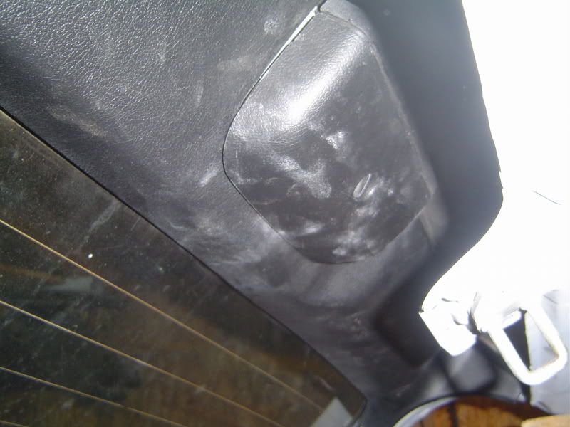

First you need to remove the 3rd brake light cover by twisting this little knob
Then there are 4 clips or screws, 2 each side. Mine were gone so I dont remember which. Then there are 2 clips holding in on the back side.
