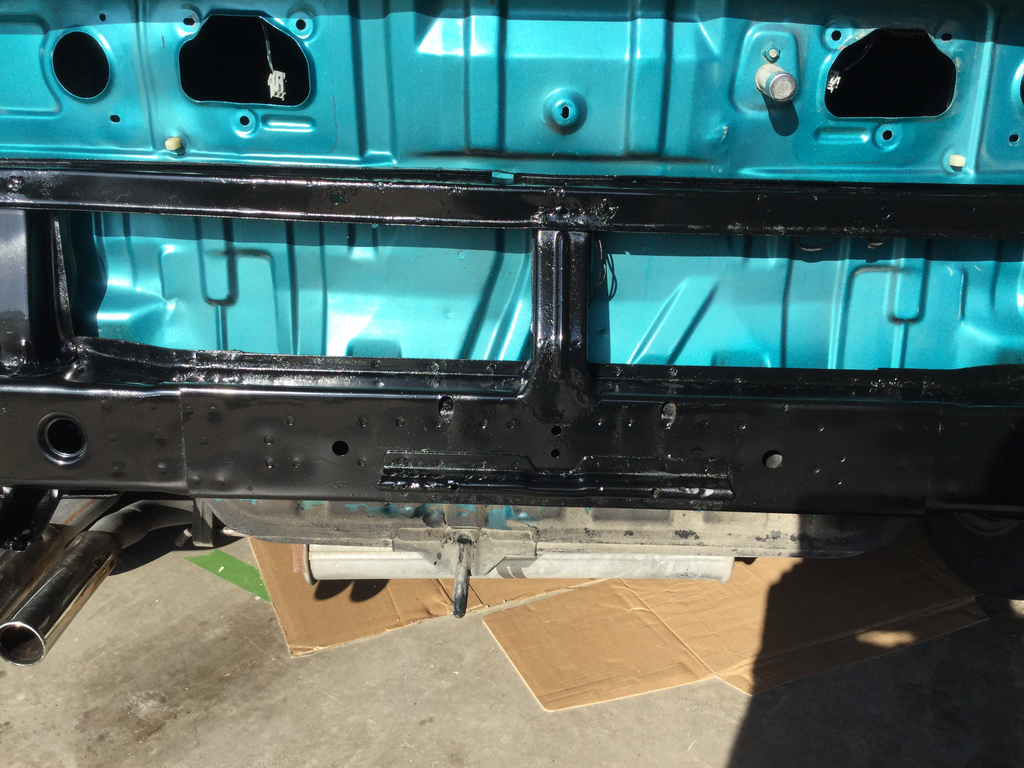

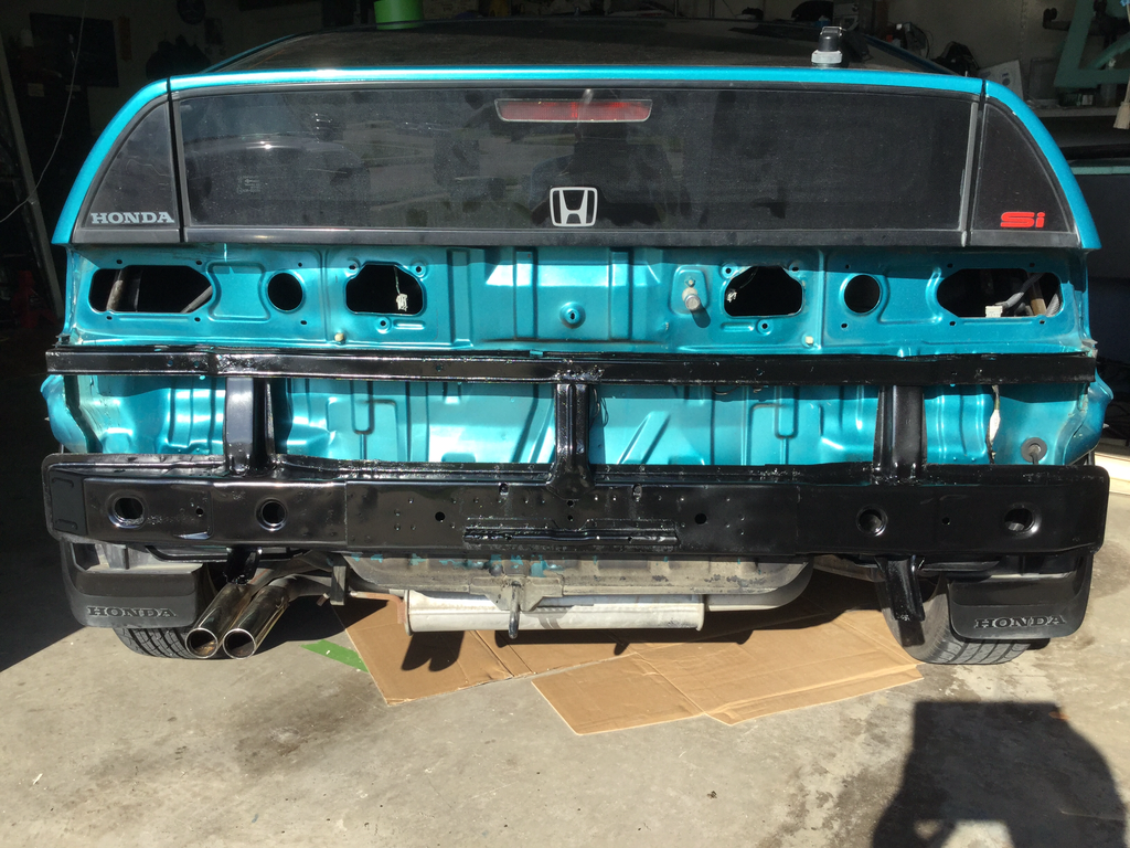

What you don't want to find when removing your rear bumper, but part of buying a norther state CRX (Salt BAD).
AND here is the fix: Sourced from Florida (No Salt, GOOD)
Sprayed with several coats of Rust Inhibitor and then several coats of Rustoleum, to promote longevity.
Wow, good job on the rear bumper reinforcement. That is gorgeous.
