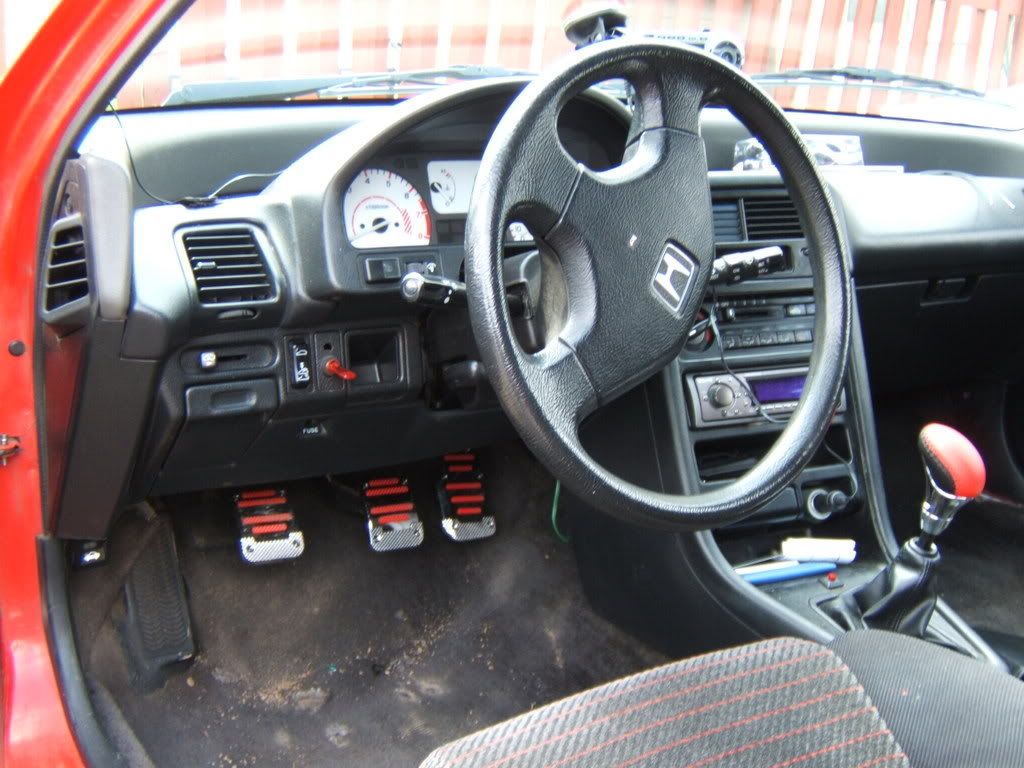

alright i got my wheel on so here is the old one:
