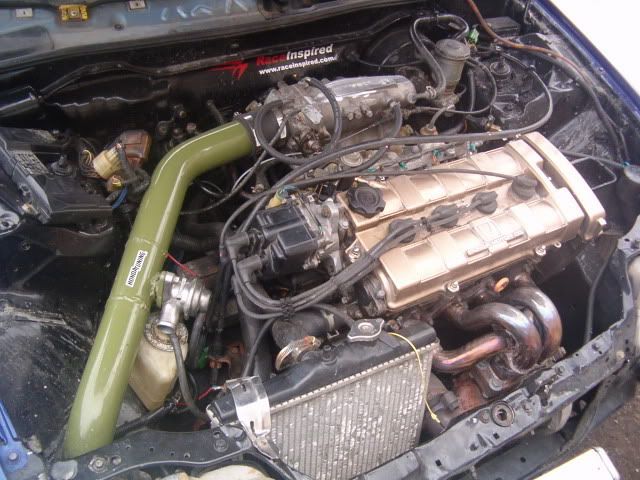

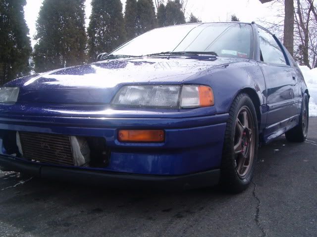

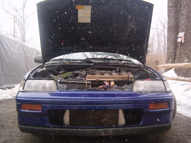

i rock an 89 crx hf i picked up about 4 months ago, ive been searching for a pretty much stock crx for a long time before i found this! the car was mainly stock aside from a gsr purple paint job, ebay coil overs, and some insane racing floor matts (in the garbage). the car had a blown tranny and i traded a sohc turbo kit i had on an eg 4dr at the time straight up for the crx.
a buddy of mine was selling an complete 5spd obd1 ls swap so i picked that up for cheap. threw it in and slapped a turbo on her.
setup includes:
91 B18A1, 92 LS tranny
Avid mounts and linkage with prothane shifter bushings :wink:
91 SI hubs/front brakes
EG Half rad
ACT 4 puck race clutch, Exedy stage 1 pressure plate
Fidanza lightweight flywheel
fully rewelded and rebraced xspower turbo manifold (this thing is pretty solid now, looks like ****)
tiny garrett .48/.60 t3 internally gated

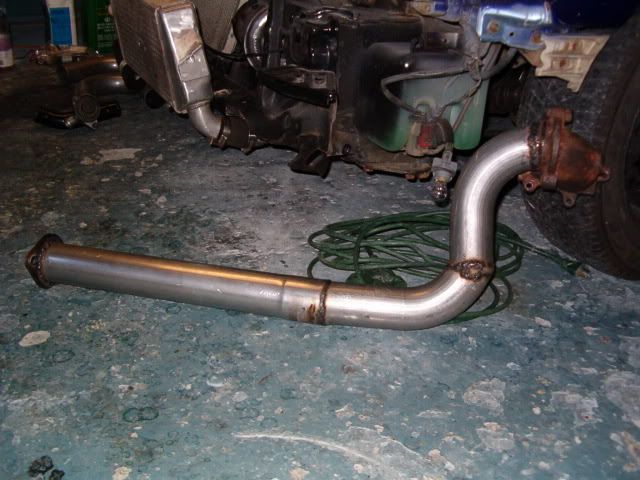

2.5" turbo back with a 25" cherry bomb
starion fmic
2.5" cold pipes, 2" hot pipes
DSM bov
B18B intake manifold (installing soon)
custom oil lines with stealthmode oil restrictor
DSM 450cc
Xenocron.com 255lph fuel pump
Running an obd0 chipped PR4 hooked up with TurboEdit
HMT manual boost controller
apexi vafc (doesnt do much)
apexi turbo timer
VDO boost gauge
bronze 96' GSR "flower" wheels with sweet pink lugs
ebay coilovers
ballin ass type r knock off shiftknob
93-98 jetta lip
relocated battery to the trunk
custom oil catch can
i think that covers it, here are some pics

phatboycrxhf said:
looks good to me :) but im not really diggin the ic pipe in that color.olive or what ever it is other then that pretty slick :wink:
everyone hates the **** green
