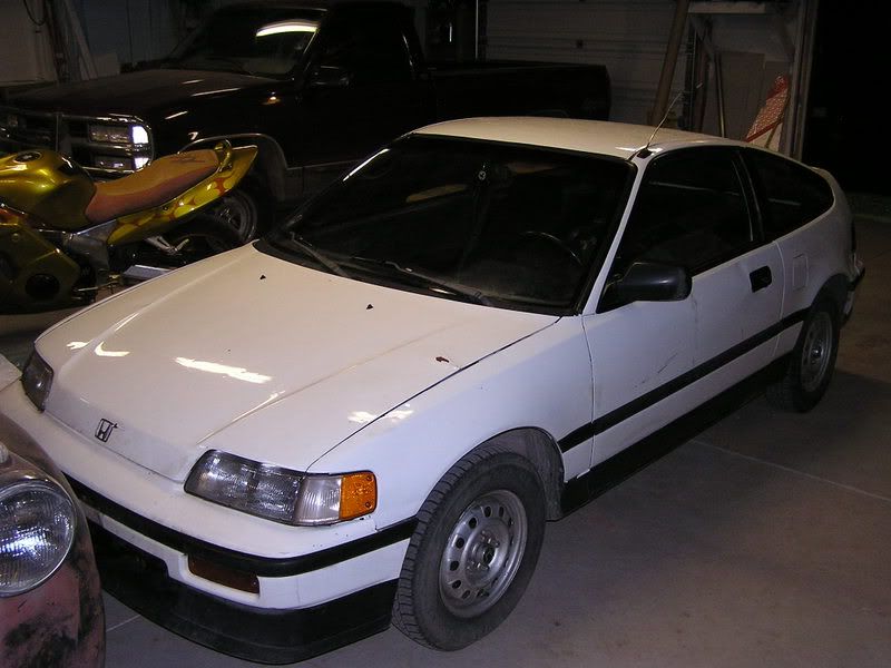

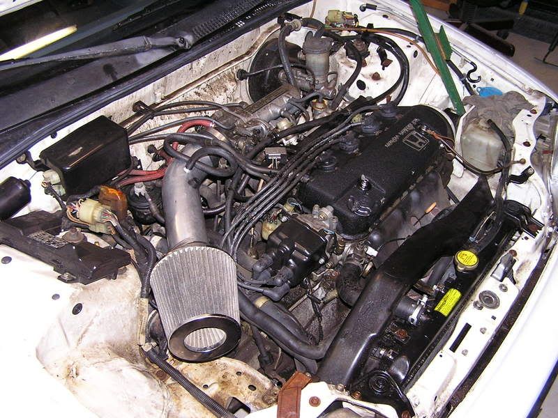

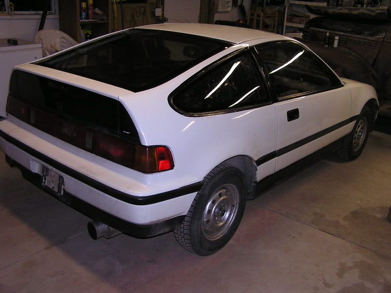

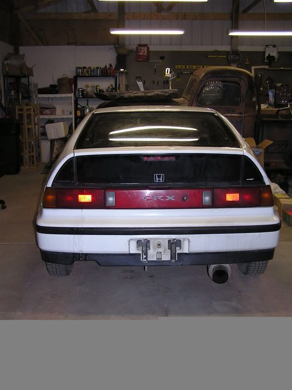

Ok everyone, well thanks for all the help, last night I bought the CRX for $1100. Here are some pictures. The body is a little rough, the engine leaks oil but it runs like hell and is a blast to drive. I have my eyes on a 90 CRX across town that was wrecked, so I'm going to see what condition its in, I'm sure I can get some parts off it.

I was told it was the DX model? How for sure can I tell the difference. Will the VIN tell me?

Krix said:
you can see on the back the remains of the HF badge. Plus you have a mpfi engine, 5k rpm limit, no rear window wiper or squirter, and no passenger mirror.
You sir have an HF model. Congrats 8)

You are currently running 62HP. The HF is a tuned down Si. It uses the same fuel injection system (one injector per cylinder, as opposed to the DX which uses two in the throttle body). The intake is considerably smaller than the SI and has half the valves of the Si engine (8 vs 16). You do have an 88 or an 89 though, so it is the lightest of the 88-91 CRX. 1988 is the lightest.
