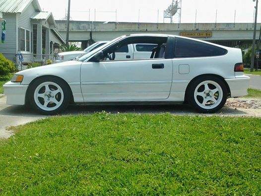

This is my first post and my first crx that i bought mainly for audio comps..in the usaci world, and many other organizations im sure, as the cheater car. Here are a few pics of a couple of systems ive built and played with at comps. I have a b18c1 sitting on a pallet id like to throw in there for track use after this year of competing.

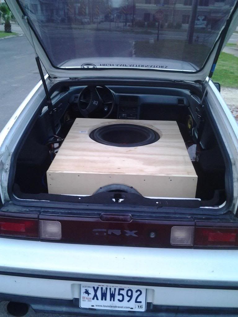

Is that a single 15 in the first shot?
I'm thinking my next box will contain 2 12's but I was throwing around the 15 idea, as I've never had one.

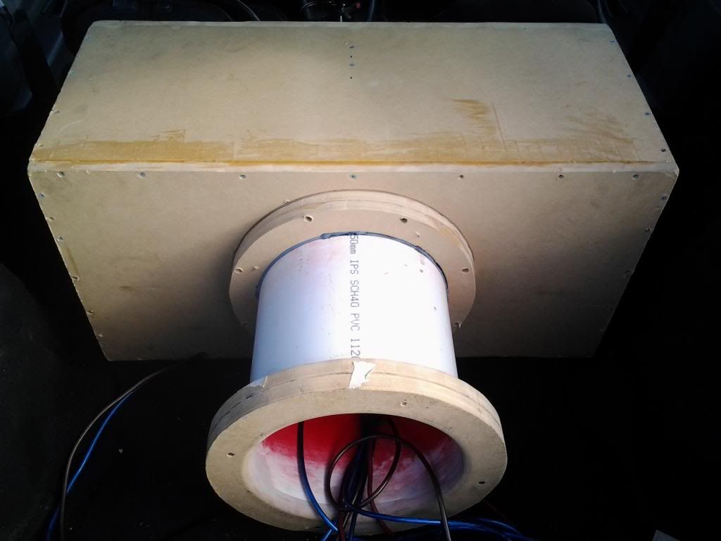

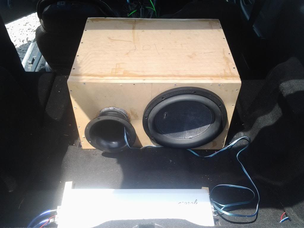

first is an 18" fi sp4 on a ct sounds 7k...gets low and loud but takes up all the room..you can build it taller as I was staying below the window line..scored 152.3 at 44hz...second is 2 custom built 15s (dlp motors, tantric softies with only 1 spider each) in an "experimental" burp box tuned to 55hz and a crescendo bc2000d for stock 2k class..153.0 at 64hz....third is my current musical setup for inbetween comps..American bass xr12, 4" aeroport 16" long for 30hz..gets down for one 12 at 2ohm on b2 zero.5. I have a 320 amp ohio amp alternator, hc1400 under the hood and kr 3112 in the spare tire well.
