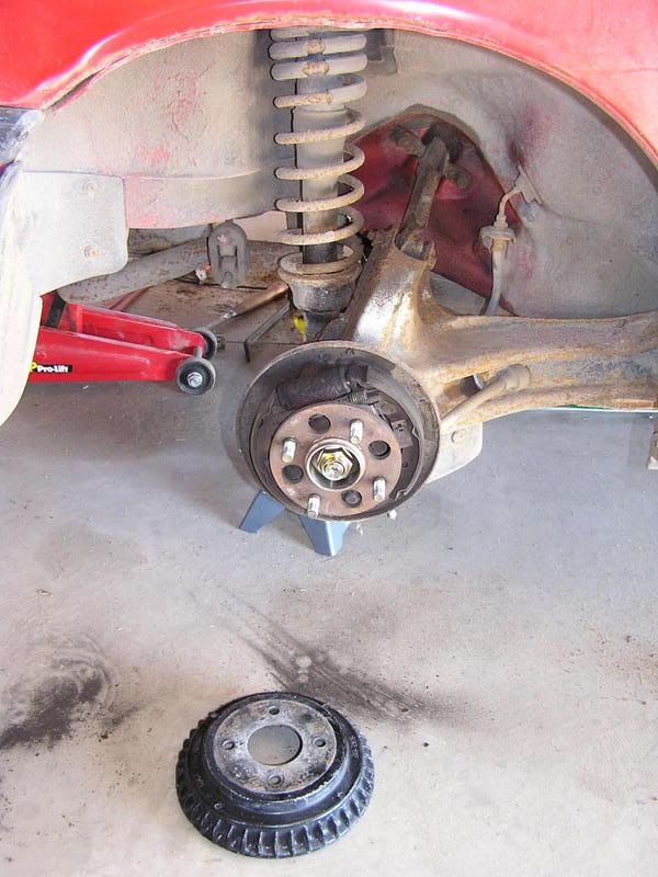

Here are some new pictures of my progress so far. I have the ST bar installed, the front/rear suspension done. The rear disc swap is complete. The only problem is I think I put to stiff of springs on the rear. I think they were 400's, paired with the bar its way to rough I believe. I might have to swap the 350's back in.

The Ground control springs are 250 up front and 400 in the rear. I think I'm going to swap the 350 springs onto the rear. Right now its to stiff and the fender gap I don't like. It sits about 2 inches higher in the rear than the front. And that is adjusted almost all the way down.

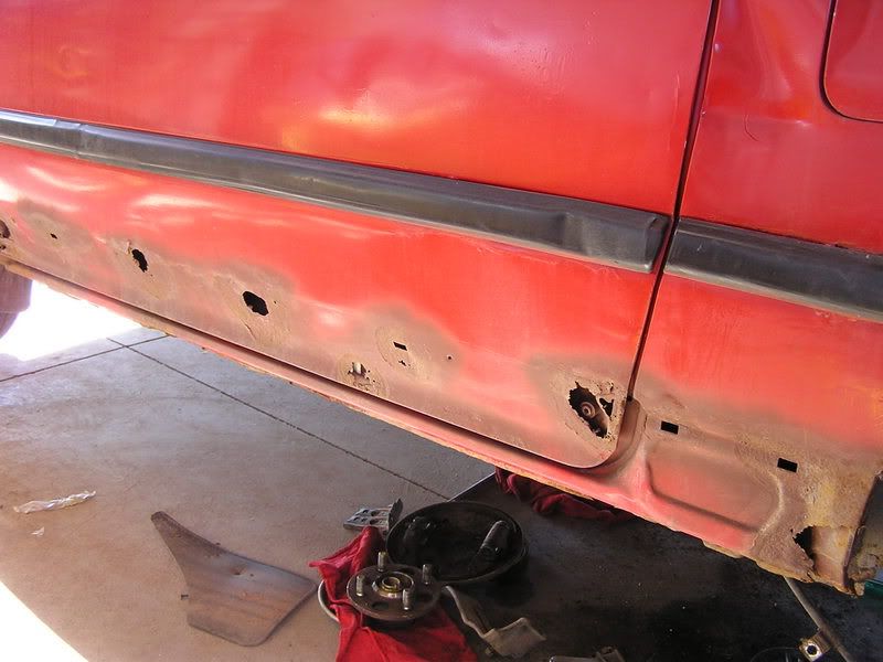

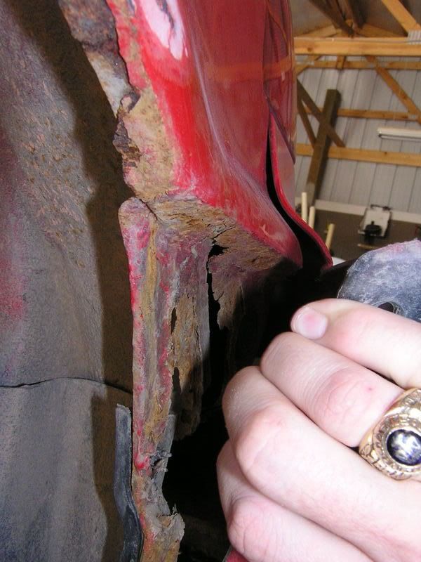

That rust looks like it has gotten quite a good start.
New rockers, different doors (or skins) will def be needed.
I have a new door skin for the passenger, waiting for a deal on the drivers side. Still trying to source some rocker panels. I think I can still order them from majestic for about 80 bucks a piece.
Any suggestions are more than welcome! I'm new to the CRX so I'm learning as I go. Somethings may not be to pretty but I'm fairly good at welding and have the tools to do so.

< same set up minus the sway bar.. I'm running the DA 'teg bar.
I don't have lines yet, nor are my disks ready to install.
56 Posts
I was running that same suspension setup (minus the sway bar) on my b16 CRX before I sold it. I was not a fan of the KYB's at ALL. I thought they were complete trash. Later I found out, by looking at the shock dyno information for them that they are in fact, ****ty. You should swap them out for Koni Yellows. They're a highly superior shock, albeit a bit more expensive.
354 Posts
Discussion Starter · #18 ·
Tell me about it. I switched the 400's in the back to 350's tonight. I'll test the ride tomorrow. Lets hope its a little more forgiving. I also cleaned up the rear bumper brace. Brace is going to get a new paint job tomorrow if the weather holds. Going to tackle the front strut bar tomorrow as well. I'll post some pictures as the progress well...progresses.
