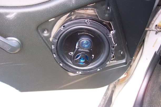

Alright, I bought my rex with some after market speakers that totally don't fit and I don't like how they were installed wrong, it looks ****ty, especially the fact that the speaker covers wont fit and I'd really like them to. So I came to the conclusion that I'm going to have to sell these speakers or find a way for them to fit. Does anyone have any suggestions? What size speakers will fit without modification in an 88 DX?

Are we talking about the front speakers? I believe the size that will fit into the stock speaker basket is 6.5" speakers, but they can't be too deep. Some speakers have large magnets and cones that make the too deep to fit in the stock basket. You'll need to measure the depth of the basket and then seek out a set of speakers that has a "mounting depth" within those limits.

Well the front and the back both don't fit. Hmmm I'll have to look into it. How much for a decent set of 4 speakers?
I found a set of 2 good quality Pioneer's last week on ebay for cheap. They were about $40 including shipping. You may be able to find lesser quality ones for cheaper.
yeah i just went out there to check them out, and its the cones. it doesn't allow the whole speaker to go in. Oh well I'll just have to sell em. If anyone on here wants a set of 4 audiobahn speakers i'll let them go for 40 plus shipping.

FWIW, I have always just gone with a 5 1/4" speaker up front, just so the speaker fits, and I have never had a problem with the magnet sticking too far back, or the cover fitting. I just realized that I have never had a problem with the cone sticking out too far. I just put in some Infinity Perfect components and they fit fine. All of the Infinity series should fit, but it just depends on how much you want to spend on speakers...

I currently have Alpine 6.5 inch speakers in my doors. I had to cut out the back of the basket with my dremel. I then installed some foam baffles to keep the weather out plus they improve the sound quality. I wrote a review on them.
As stickershop said before, you can install 6.5 inch speakers but the depth is going to be a problem. As stated before Infinity make a great speaker that is usually pretty slim.
Yikes! I bought some PIONEER TS-A1671R 6-1/2" 220WATT 3-WAY's from ebay and they fit *perfectly* in the doors. I highly recommend them because of their slim profile. :)b
