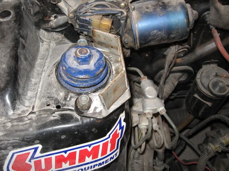

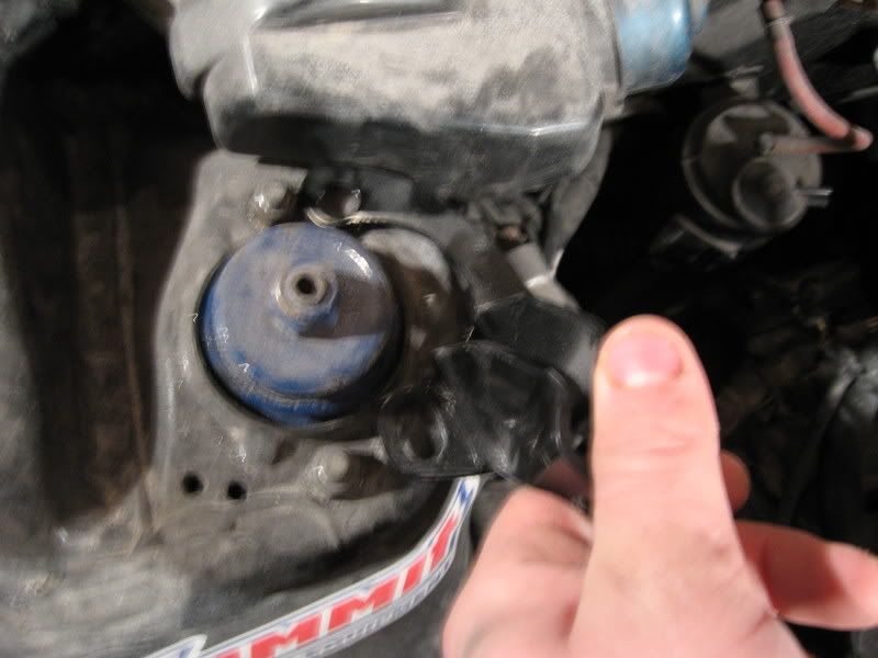

well i picked up a ebay strut tower brace for a 90 to 91 crx si ,but it didnt fit the first gen lol , so i modded the **** out of the mounts check it out
as you can see in this pic that the hole wasent even close ,and the bolt holes were of allso
at first i was just going to make the hole bigger ,which would work fine ,but i choose to go another route

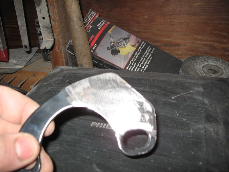

so i marked where i wanted to cut first
and chopped them off ,and found rust under the paint lol fudgen ebay lol
cleaned up

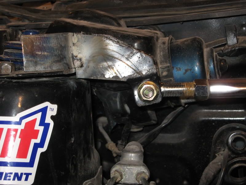

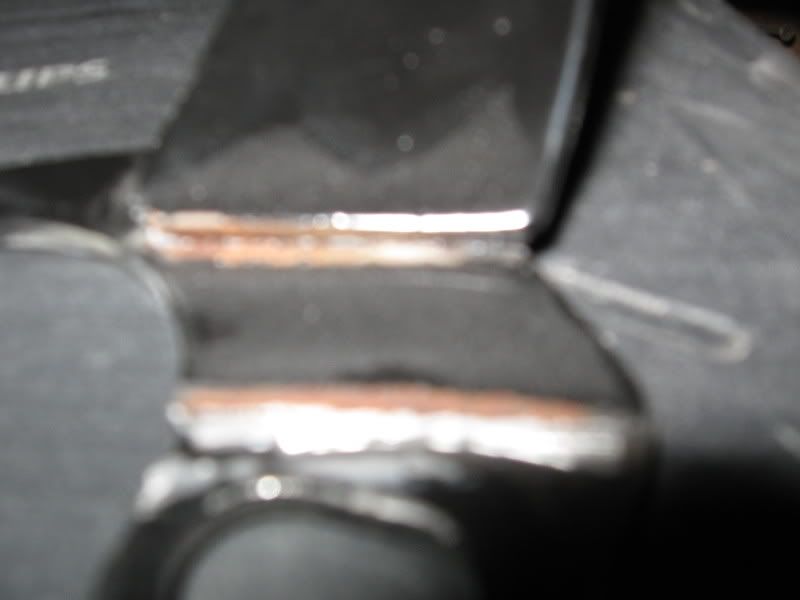

then i took the mount and cut the ends off ,then welded in my own peice
welded here and here

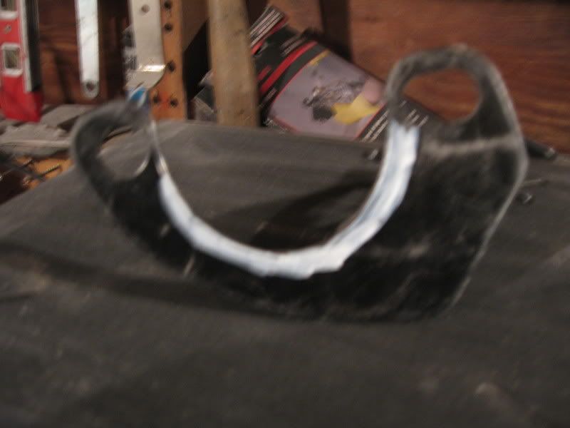

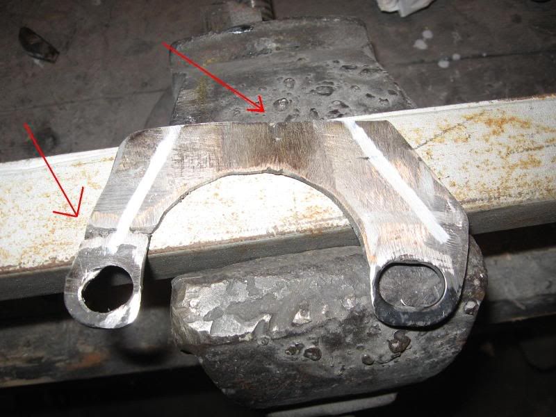

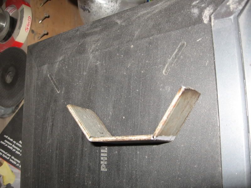

then i took some plate steel and cut it to 6 inches ,then messured 2 inches on each side and notched/csored it with the grinder it so i could put the bends in
then i lined it up for a test fit ,cleaned it up i tacked it to the base of the mount

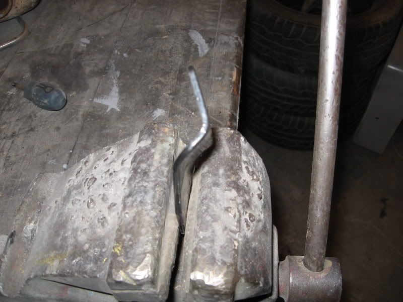

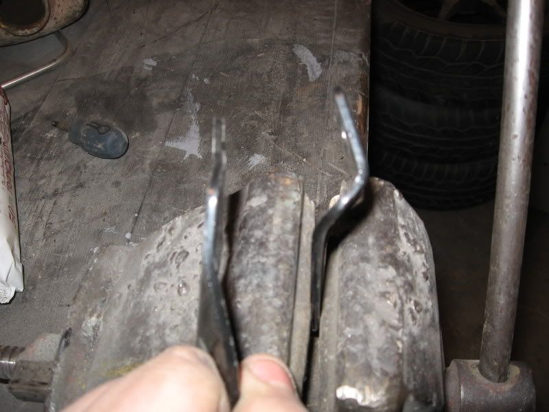

then i took the brace hangers and had to straghten them to mount right ,so i just threw them in the vice lol
still not straght so i hammered the rest out :wink:

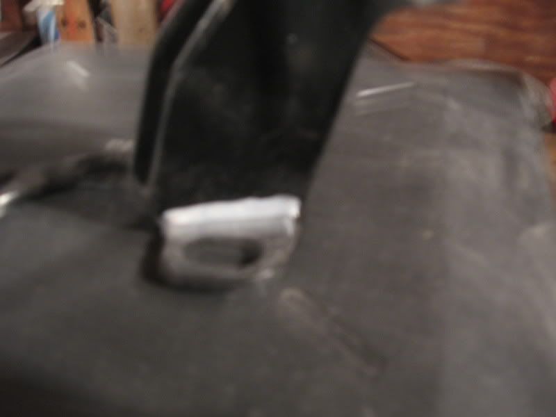

then i had to straighten the hangers so they didnt point up ,and then tack welded on
here is a side by side pic of the mount before and after
as you can see there will not be hodd issues now and allso there will not be carb issues
