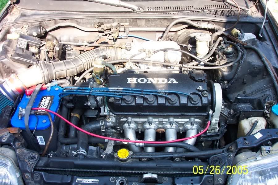

I have a mini-me in my current car, and still don't have it right.
Getting frustrated with it, the zc was sooooo simple compered to this.
(please ignore the temp intake)
