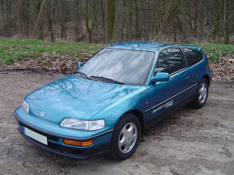

just wondering what that thing is on the wiper. it looks like a deflector. any info on whats its called and what it does would help. thats the second time i've seen this on a crx and wondering what the heck it is. i didn't know where to post this up, sorry if its in the wrong place.

I've got one. :D
It adds downforce to the wipers to prevent them from chattering or skipping over the windshield at highway speed. The front wipers are connected by a linkage and run from one motor, so you only need one wiper spoiler. (I don't know what it's officially called.) Stabilize one and you stabilize the other.

I bet it actually makes a substantial difference, at interstate speeds the wipers don't work that well, because they don't push down against the windshield very hard. Once you're in town, they work fine. So, having the wind push down on the wiper rather than lift it up would help out. At about 120mph, the wipers actually lift OFF the windshield and hover there. Err, so I've heard.
