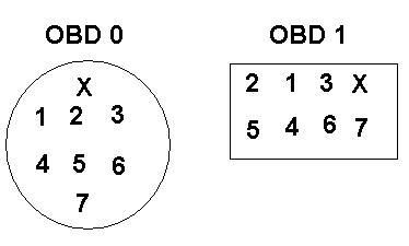

ok the real question here when you drop in your motor what engine harness did you use? by the sound of it you used the HF engine harness. you should have gotten the z6(D16z6) harness. i understand the rywire harness how it helps w/the ecu/distrubiter jumping from ODB0 to ODB1. but there are other easier ways in the converstion. if/and you're changing your engine the engine harness is a start. second the rywire ecu jumper helps also. then to avoid headaches w/the dizzy here is a chart that can help you:
with this you can rewire/resolder and coverted the dizzy so use the HF plug. so in turn all you doing is cutting the wires from the 4th gen to make a 5th gen work.

i got the car from a buddy, he did the rywire vtec subharness and OBD I jumper harness. I have the dizzy from a z6 with the OBD I plug soldered to the OBD 0 harness. I'm guessing the HF motor doesn't have a MAP or IACV? I also have the original d16z6 harness, but I'd rather not go through the hassle of redoing it all.
