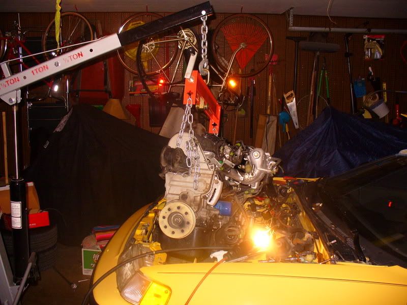

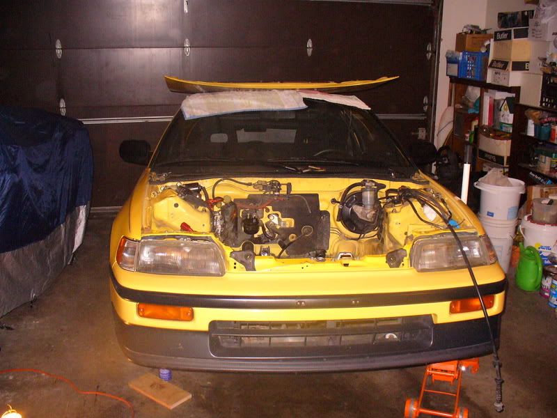

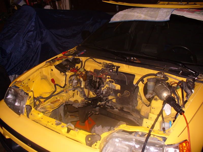

Well I flip-flopped on going Y8 mini-me/turbo swap or the B16...and only after I started ripping it out is when I decided for sure on the B16A2. It'll be a cleaner swap, and will resemble what it should have been from the factory. I figure if we're taking this car's virginity, better do it right. ;)
Don't worry, it's cleaned up better then that now.
The aftermath on the front mount...
Bart doing what he does best...
...punishing the Y-49.

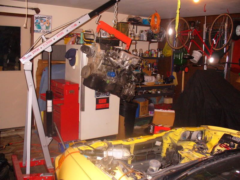

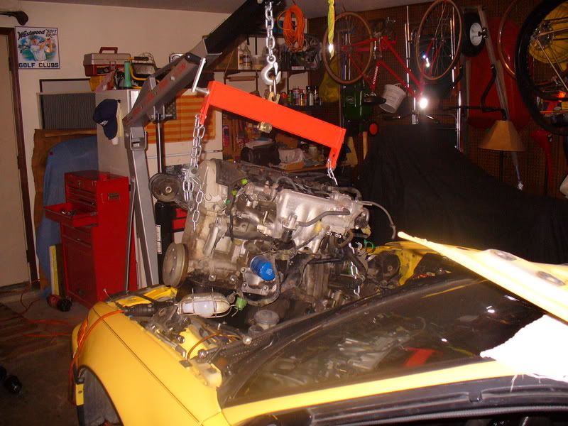

What's going in?
B16A2 from a 99 Civic Si
Looks pretty clean, huh?

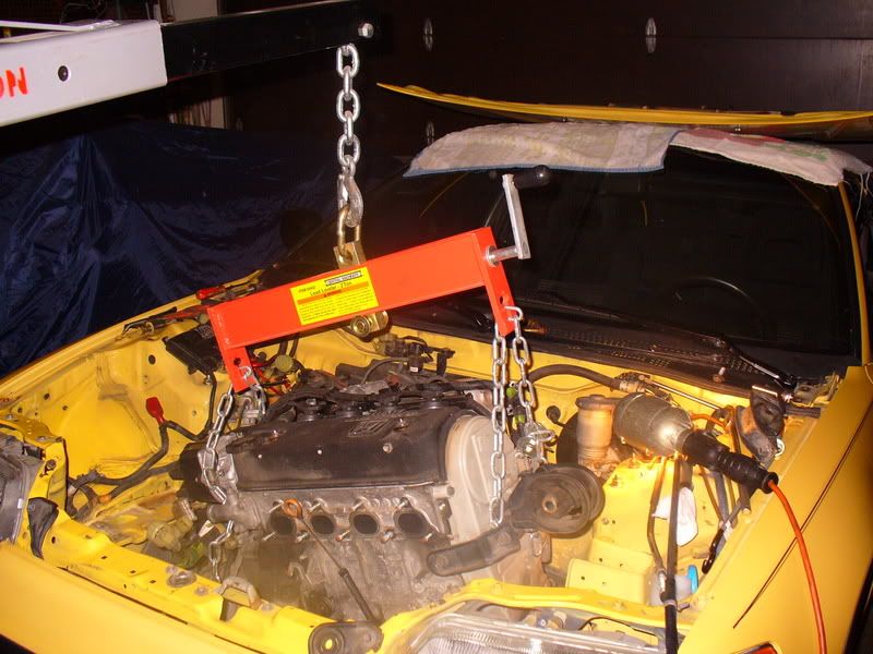

Check this out...
Realized this was broken a bit late in the swap. :oops: Definitely need the rear motor mount. Tried contacting the guy I got the motor from,...doubt that'll go anywhere though.
I called a few machine shops around town to see if anyone could weld cast aluminum. I spoke with one place that builds engines and talked to the guy that does the welding for about 20 minutes describing it and they said they could do it. Took it in last Wednesday and, three guys come out to look at it,... "No. No. and No." They did recommend some welding shops. Couldn't do that over the phone I suppose... :rolleyes1:
Anyway, I'm taking it in Monday to a welding shop that should be able to do it. Depending on if they can or how much it costs, I may just have to go Frankenstein with this and find a B20 block. We'll see....

I have no idea...it was like that. Wish I would have noticed it before I bought it. :x What a pain in the ass.
Doesn't sound like it will be too tough to make it work though...
http://www.honda-tech.com/zerothread?id=1860643
Just need to find the right place to do it.

Just support me in my decision to go this route, because the front mount is gone, the bay has been dented, and the block is going to the welding shop tomorrow.
