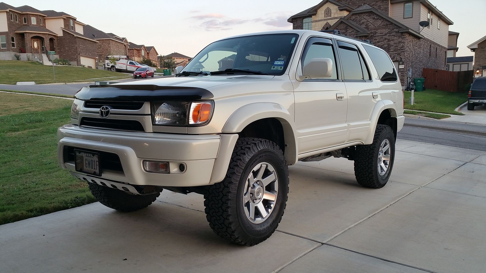

Also snapped a couple pics of the 4Runner after I installed some Bilsteins as well as the new TRD Pro wheels 8)

jdmhondamotive said:
awesome build bro! nice 4th gen Runner. I too have a lifted Runner, 3rd Gen though. Keep up the good work!
Thank you! and that's a nice looking 3rd gen :)b
