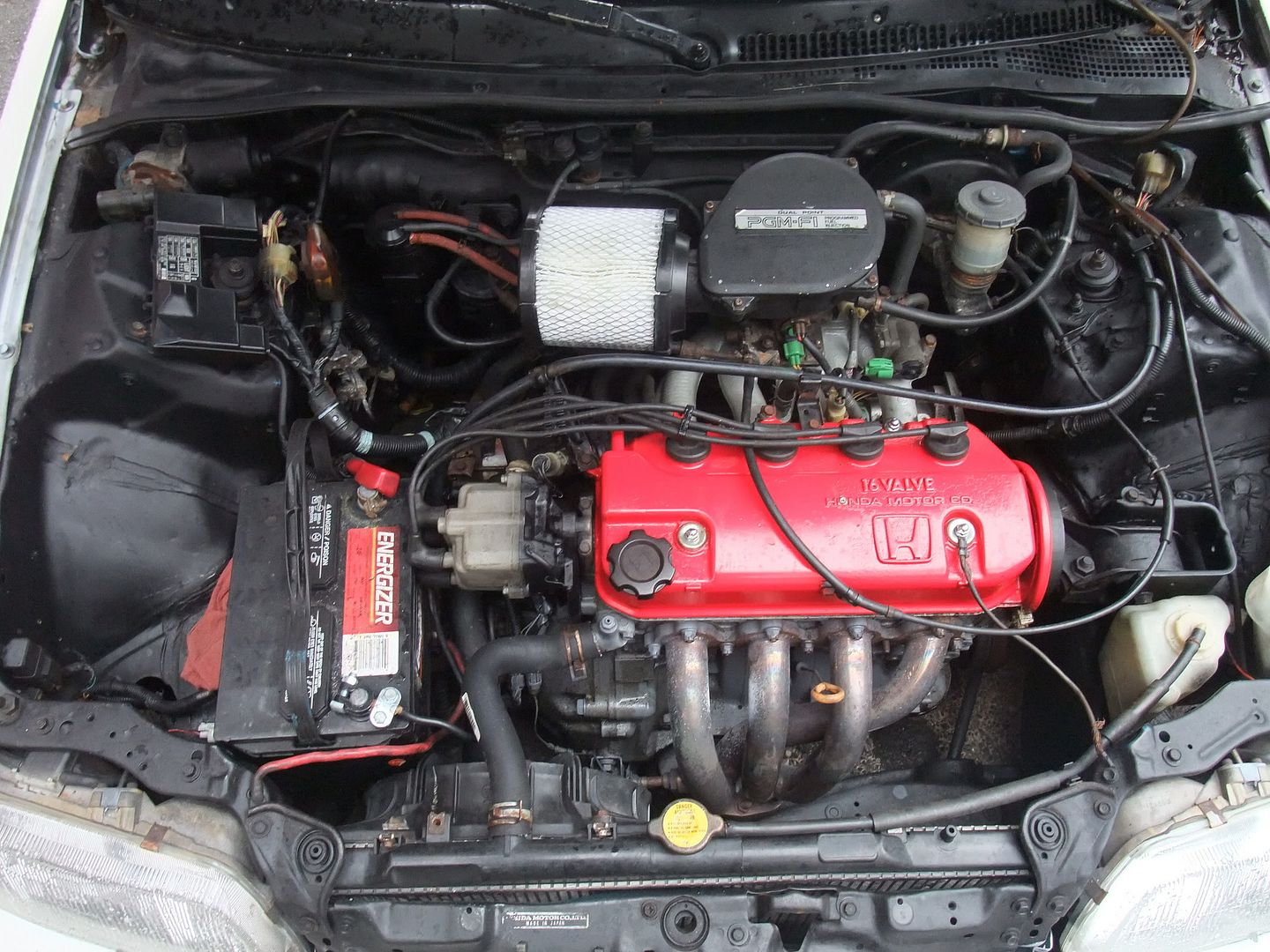

#5 ·
Thank you so much for the info. I found a "HF" in my state for a good price as a recondition candidate. Im not sure if it is an HF as he has said. Theres a moonroof but that can always be aftermarket. I cant see the HF on the back of the car with the fuzzy picture however there is no rear wiper blade but a dark spot where one could possibly be attached.
For a 91 HF the vin is: JHMED8351M5008181
But from IDing it by the vin i believe the 8th digit has to be a 6 for CRX so something is off?
He gave me this good picture of the engine if anyone could identify that its an HF engine for me. IMG'ing the picture would be to big for a forum so here is link:
http://i177.photobucket.com/albums/w227/robert-0137/DSCF5803.jpg
