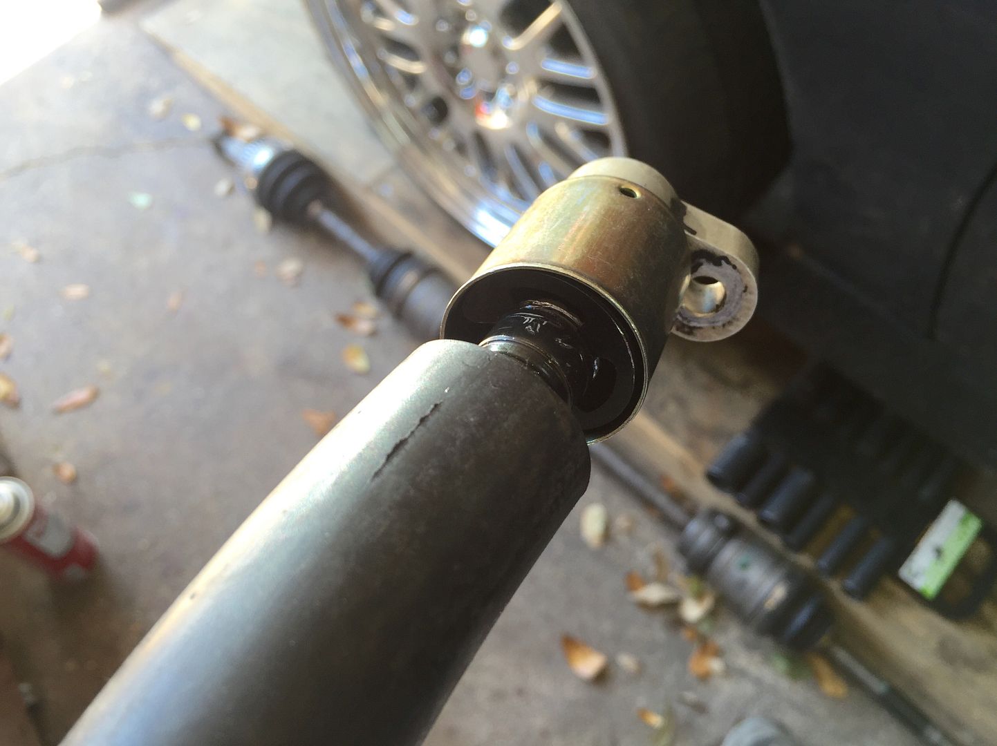

I did not source uncrimped fittings. You are correct that once crimped you cannot remove the hose.
You must cut the ferrules off and then cut the hose off, and voila you have an uncrimped compressor side fitting. This gets into the territory of why this stuff is "custom" ;)

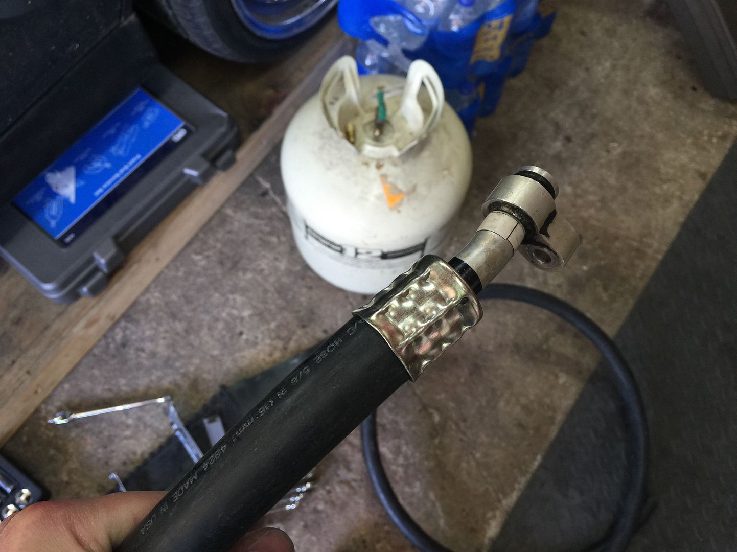

I don't know about the being the "king" but I have learned a lot from tons of reading on the web over the years. I must also again point out that the idea for this swap wasn't mine, JMZ400 on Honda Tech had the initial idea for the TRS090 and custom hoses (although he still hasn't totally finished his as far as I know). There are a few AC specific forums that I have learned a lot on. Plus having to re-do my own system over and over and over (and blowing lots of money in the process) in addition to having worked on the AC's of several other EF's, it has afforded me invaluable learning experiences on these cars specifically. :biggrin:

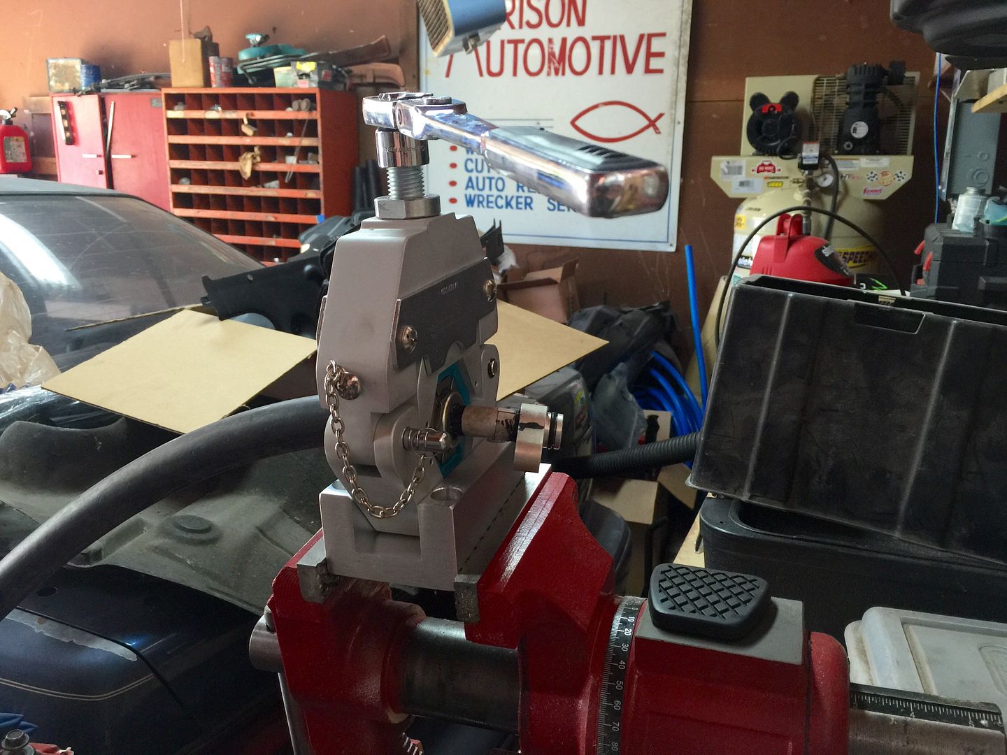

Very long story short, AC hoses are crimped onto the hard lines/fittings with metal sleeves called "ferrules". If you remove the existing ferrule, you can then cut the hose off and you are left with just the hard line/fitting. You can then use new hose, and use an AC crimper tool to crimp a new ferrule onto the hose. Doing this, you can pretty much join ANY two fittings/lines you could possibly want to join by adding new hose in between. It is of course not THAT simple as you have varying fitting/line diameters, varying AC hose sizes, an assortment of adapters, etc. but using combinations of all the above you can pretty much build any hybrid/custom hose you could ever want as well as fix just about any factory hose.
It took me a lot of research and some blown money/trial and error/testing and dealing with some very unhelpful/dismissive AC people to figure this all out but it's really very simple once you know how to do it. Not necessarily "easy" as it does take some skill to not damage your fittings, etc. but the actual steps are simple.
I'm pretty satisfied about it really, because as best I can tell it's frowned upon by dismissive AC "experts" who view this style of repair/customization as subpar and prefer to take AC lines to shops to have them braze on new fittings and/or braze/weld the hardlines together directly as opposed to this ferrule method. So it's kind of an "in your face".
And this is not to say that I have discovered some hidden secret at all regarding making custom hoses - all this info is out there in bits and pieces if you look long and hard enough and anybody can figure it out just like me. Although just my descriptions above gives anybody a much better and encouraging head start than I had. :rofl:

If anybody is seriously interested, I'll make these custom AC lines for $230 shipped in the U.S.
That price includes me supplying all the fittings/necessary parts and shipping complete finished units to your door. It will require no legwork on your end as far as hunting down EG and CRV fittings or supplying a factory EF condenser side hardline.

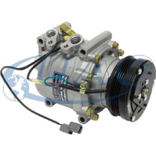

#33 ·
Any info on doing this with a TRF090 Compressor (EG R12, Prelude R12&R134A). Its a R12 compressor , but I think Honda also used it for R134A applications as it comes up in parts lists for 96 prelude. It has fittings that look identical to CRX. Perhaps a TRF090 could be mated and run R134a (like a 95 96 Prelude) without having to modify lines ?
I wonder if the only major difference between a TRF090 and TRS090 is the fittings, in that case I think a TRF090 would run great on R134A.
Thoughts ?

I don't have pictures of cutting the crimps offhand. All you do is take a cut-off wheel and cut right through it. Just don't cut all the way through the hose and damage your fitting underneath. And obviously don't damage the beadlock groove.

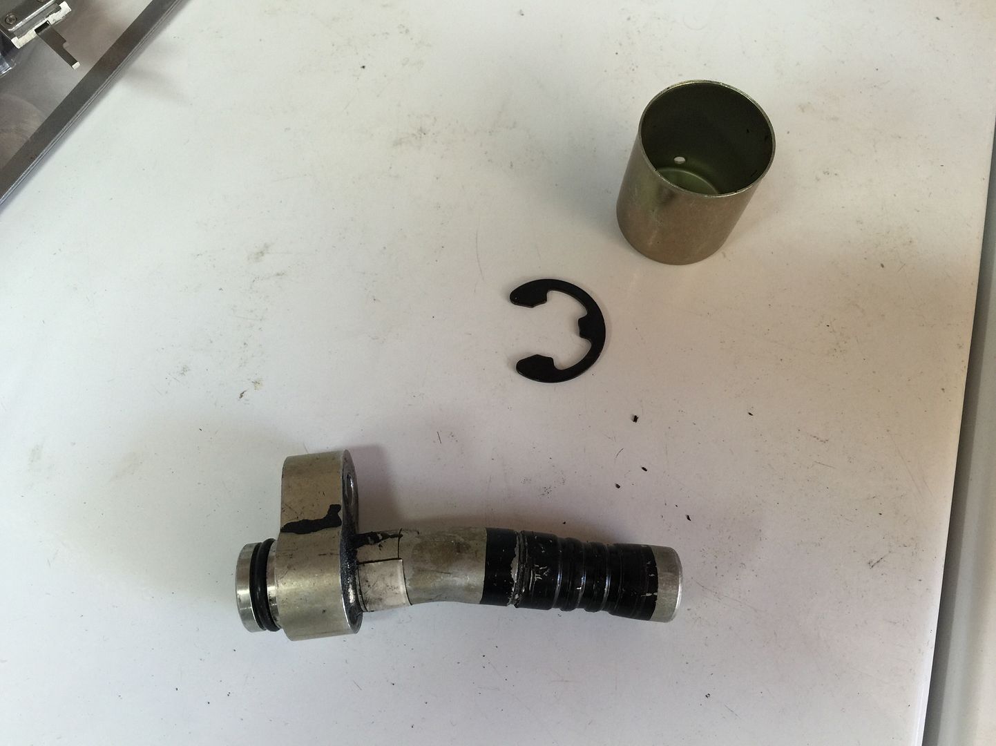

#43 ·
Before crimping the ferrule looks like a straight pipe fitting over the hose outside diameter. After crimping it looks like what's on now. The tool basically looks like a giant vice. There is always Google pictures if you want to see one. You are way overthinking this!
Ferrules are bought seperately, there are dozens of different end fittings.

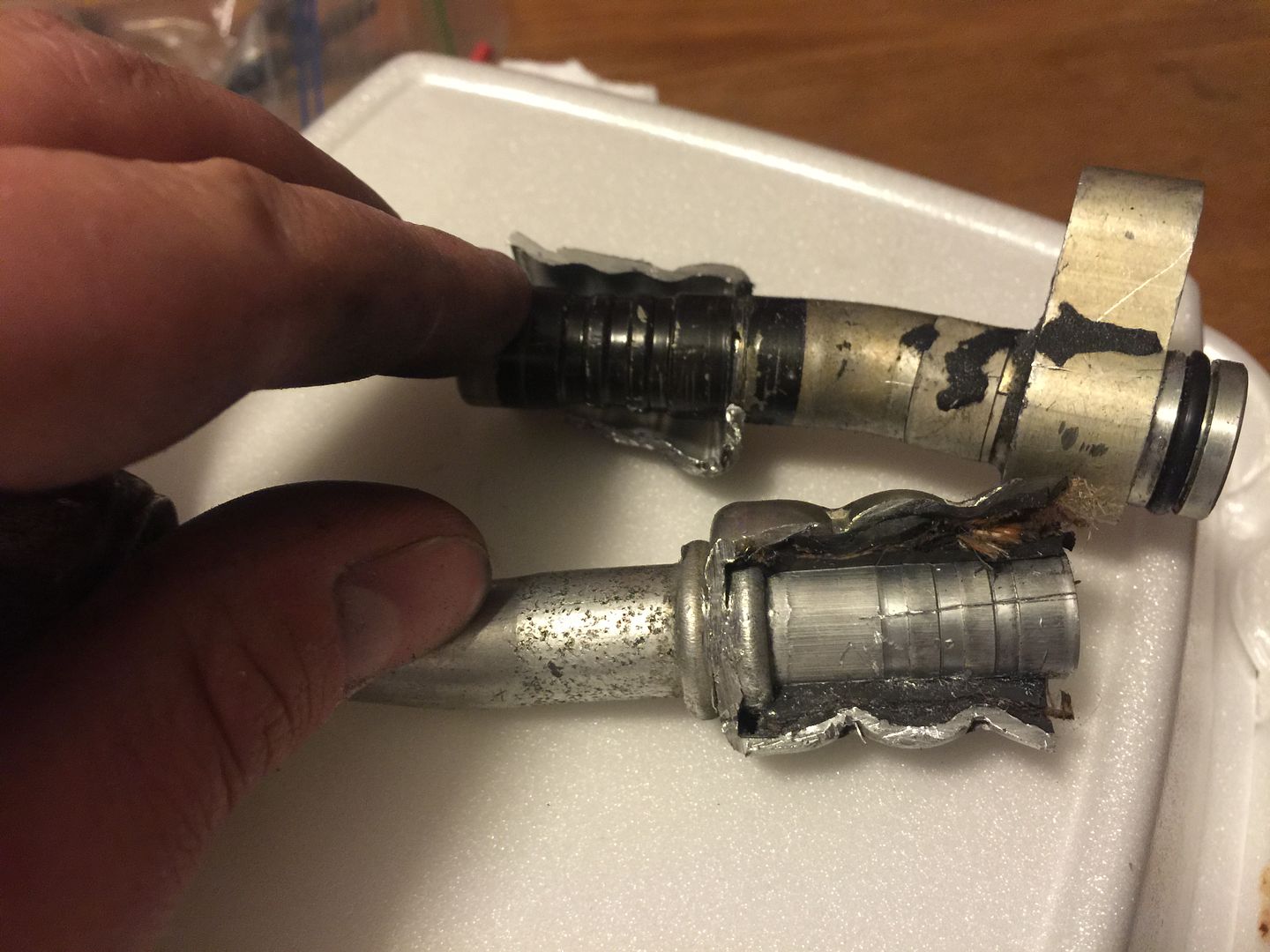

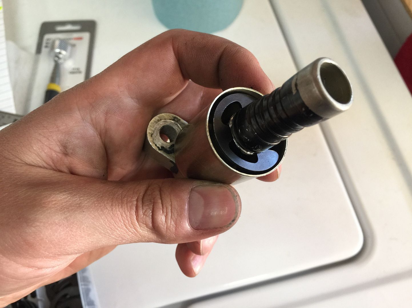

#44 ·
This is something that took me a lot of trouble to figure out/get answers. I almost hate to just spell this process out on a silver platter as again it took me forever to figure it out but oh well. You'll see it's really simple actually, so I guess I shouldn't be secretive about it - but as you have discovered, despite how simple it is it's not all that easy to figure out remotely and web resources are lacking. 8)
Here are two different styles I cut up to show a sort of cross section, this should really help you. The lower one is from an EF. See the two large ridges? That's called a beadlock groove.
The upper one is from an EG. Notice it does not have two large grooves, but rather it has a recessed groove.
Now, these two style are inherently the same thing. If you'll notice, the ferrule sleeves fit into the grooves. This is what holds the sleeves, and in turn - the hose, in place. When you cut these off, the new ferrule sleeve fits right over the whole thing. Of course, because your new ferrule sleeve needs to be able to fit over your groove, then the issue becomes how do you secure the ferrule sleeve into the groove?
You slide your ferrule sleeve over the entire groove, then use a C or E clip to pop into the groove. Slide your hose up until it rests against the C or E clip, then slide the ferrule sleeve back down onto the hose until it also bottoms out on the C or E clip. Then you crimp the new ferrule down and voila.

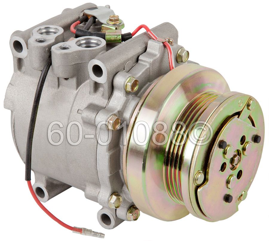

#47 ·
"So I'm not sure what advantage you would have by seeking out a TRF vs a TRS. Same thing. "
My theory was that the TRF has fittings that look identical to CRX fittings and this compressor could likely be mounted WITHOUT custom lines, maybe just a slight bend of the OEM style lines. Of course I would still want to get new lines with barrier hose if the TRF would bolt up and seal to CRX R-12 lines that would save the cost of a crimper and all that hassle of custom line building.
TRF090 on top , TR70 on bottom. fittings look spot on as far as how the o-ring seats. Im thinking instead of making custom lines the crx lines could just be bent slightly forward to accomidate the TRF090.
#48 ·
I see what you're saying now. That's a very good observation.
I just looked up the 92-93 EG Civic suction and discharge hoses. The EG 92-93 suction and discharge hoses have compressor side fittings that are the same style fittings as the EF Sanden TR70 compressor fittings. The 92-93 Civic hoses are different part numbers from the 94-95 Civic hoses.
You actually may be onto something here, the big kicker here would be the diameter(s). The TRS090 fittings are a larger diameter than the TR70. But if the TRF090 openings are indeed smaller, as it looks, then you actually may be onto something here.
