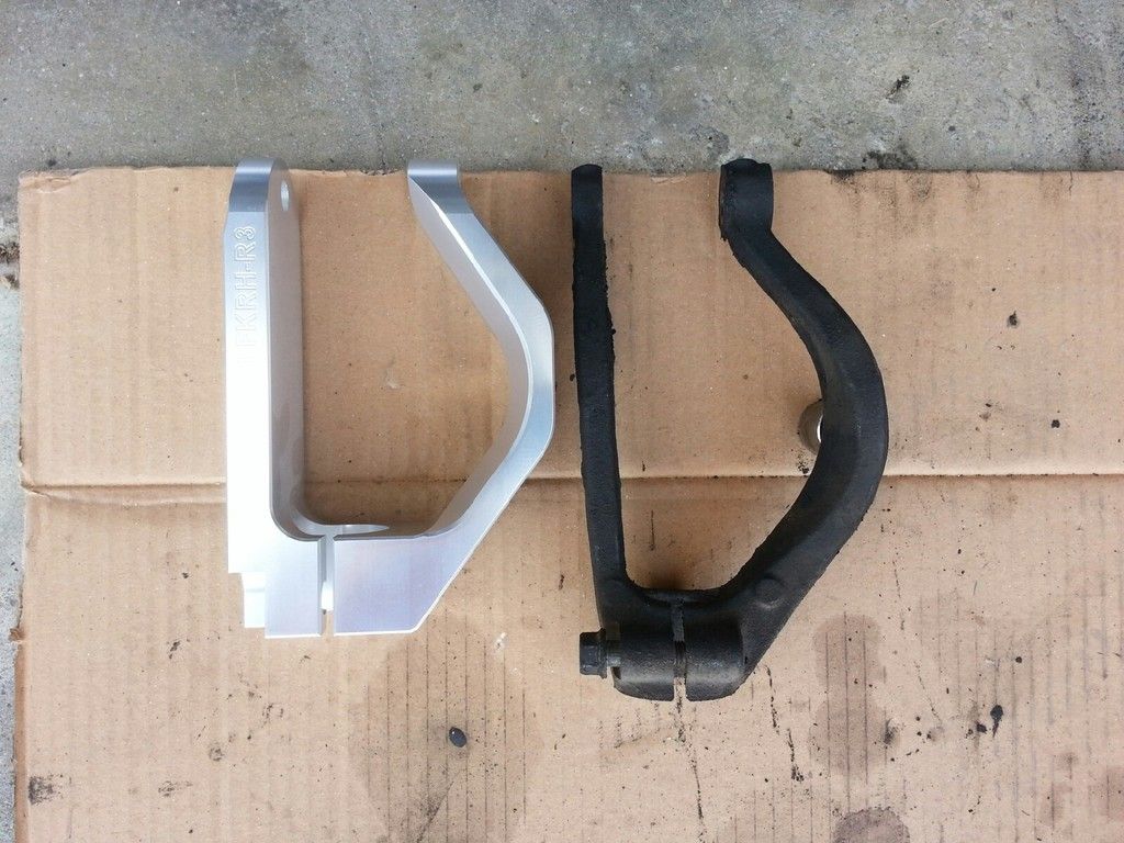

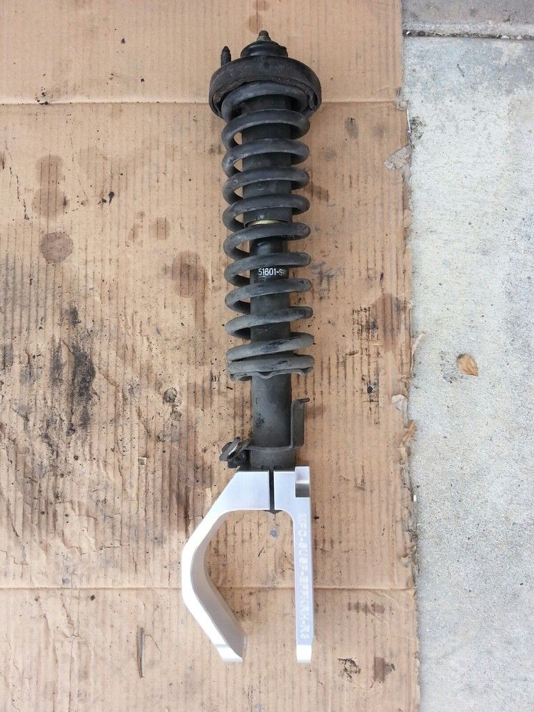

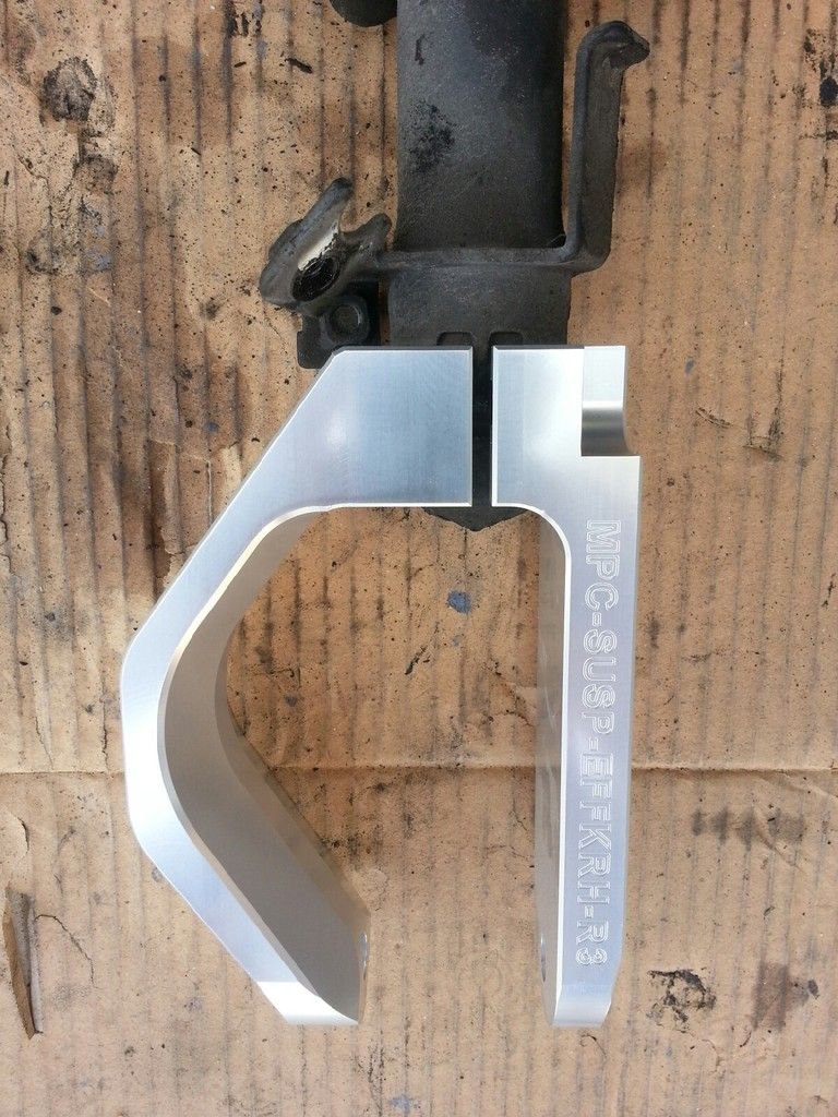

today since i have my crx apart i am testing fitting the MPC lower forks with the stock suspension so everybody can get a good look at it. to me so far it fits pretty good. if there is a particular shot you don't see and need to know let me know.
more test fitting will come when i get my other crx apart running ground control with konig struts.
