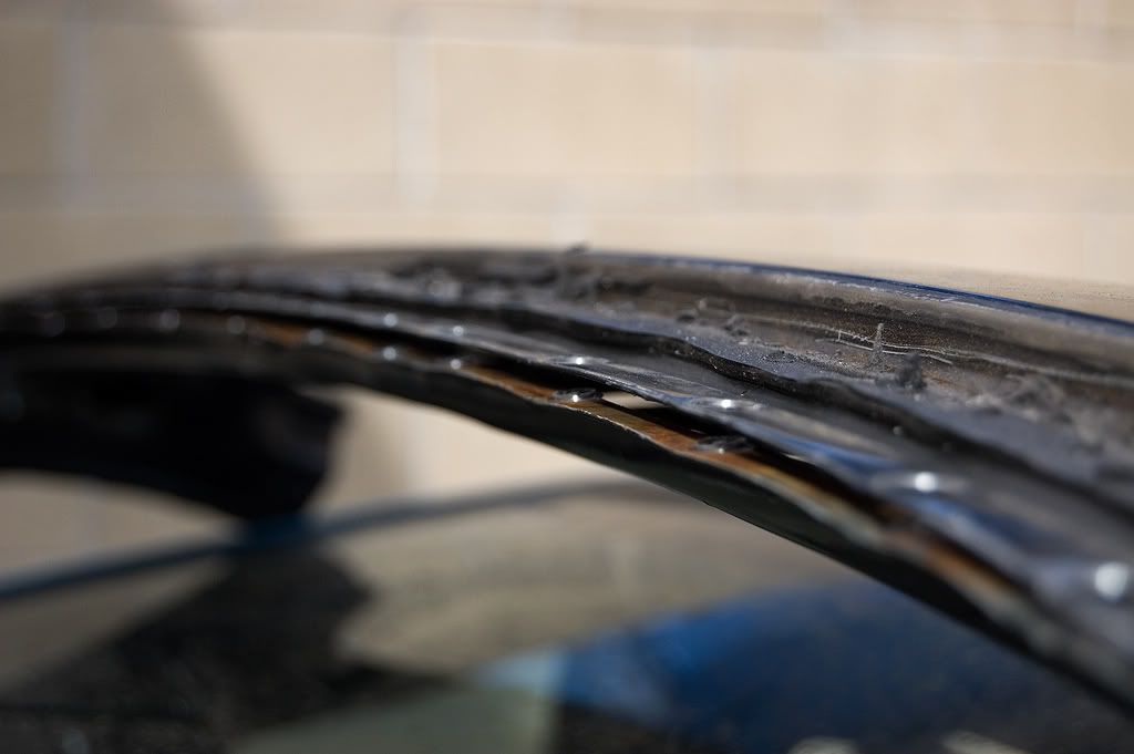

This past Sunday I took the top to a glass shop here in LA (They have taken numerous glass tops off so they know what they are doing) So I picked up both pieces about an hour after I dropped it off, I had told my brother if the glass broke it was because it wasn't meant to be! :smash: But sure enough the glass came off without a hitch and I drove home a happy camper!
The Day I picked it up!
What it's going on!

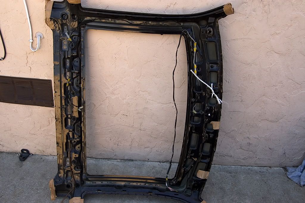

And here is what it looks like once you get the glass removed, and all the panels removed...

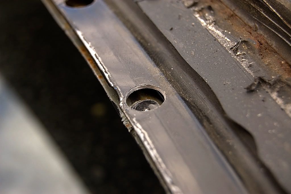

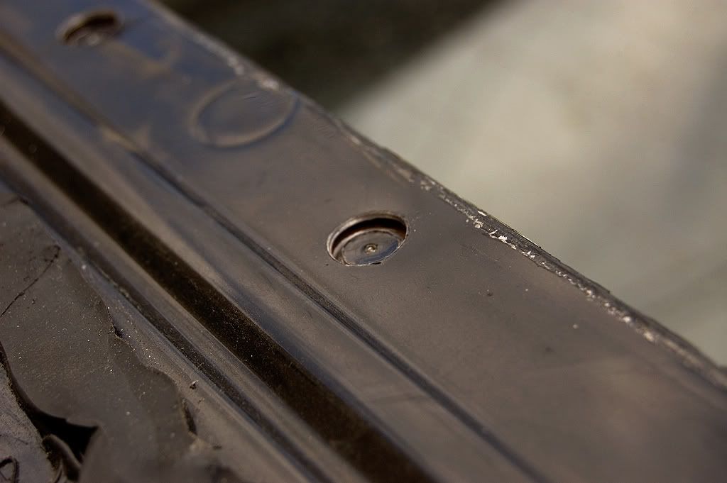

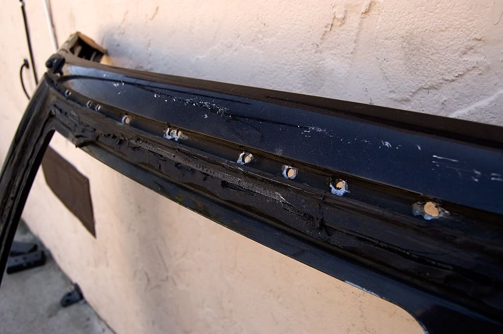

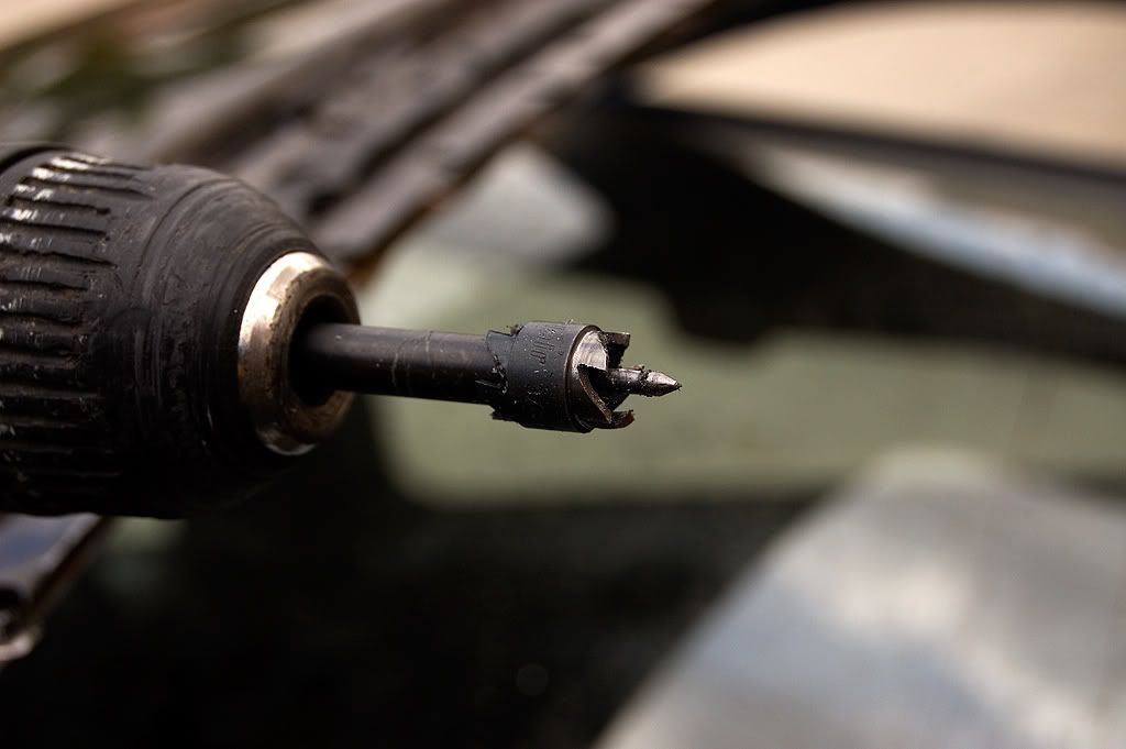

Let me tell you something I ruined my drill bits! :( These spot weld are really tough and take a long time to drill out...It took me a while to get these right here drilled out
My bits were working at first but would quickly lose there bite...so I started asking around some of the local body shops what they use and they all pointed in the same Direction!

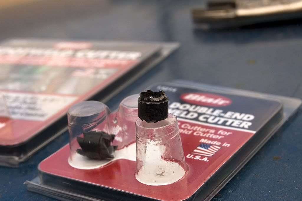

Blair Equipment sells a really sweet Spotwell removal drill bit! This will make your life so much easier! It doesn't dull down because it cuts around the spot weld instead in directly into it! and its super fast!! Make sure you also have a Center Punch as you will need it!!!
Just make sure that you read the instructions! I ended up blowing up 2 bits because I did not read the instructions right! You have to be gentle with these bits, once you get the hang of it, it's like baking a cake!
Broken bit from not following instructions!

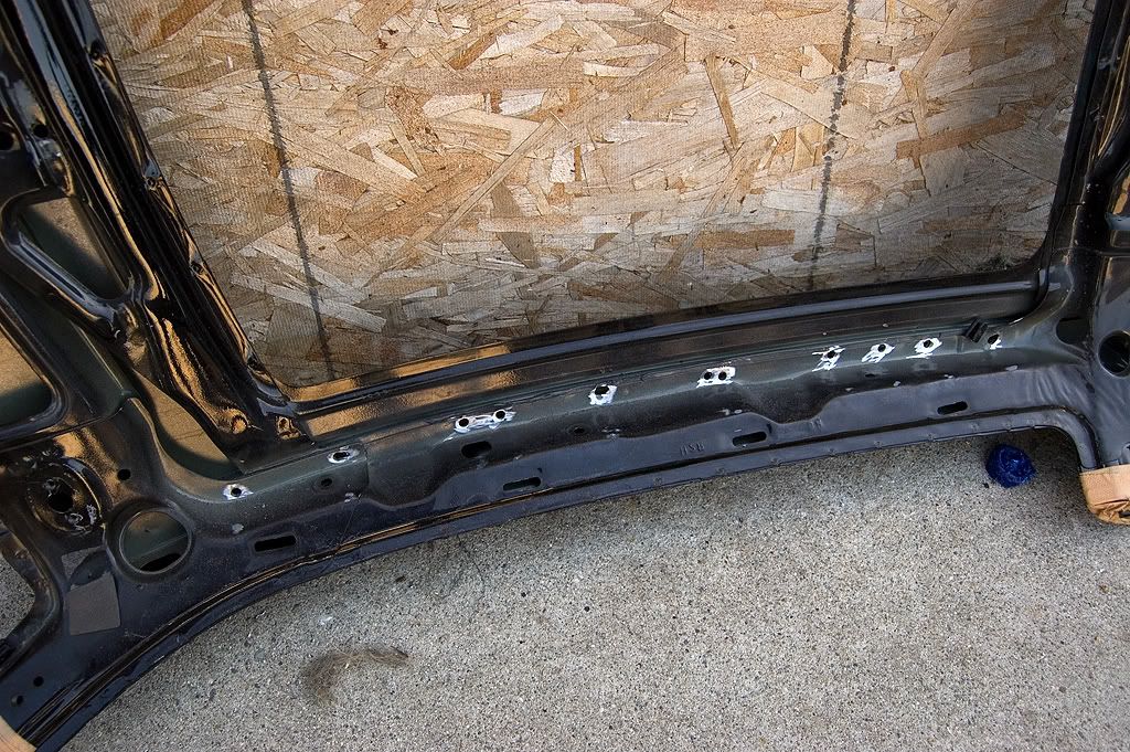

And end results! It took me like 30 mins to get the welds off compared to about 2 hours the other day!

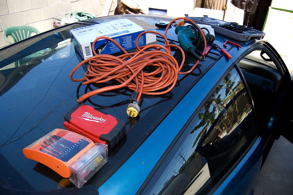

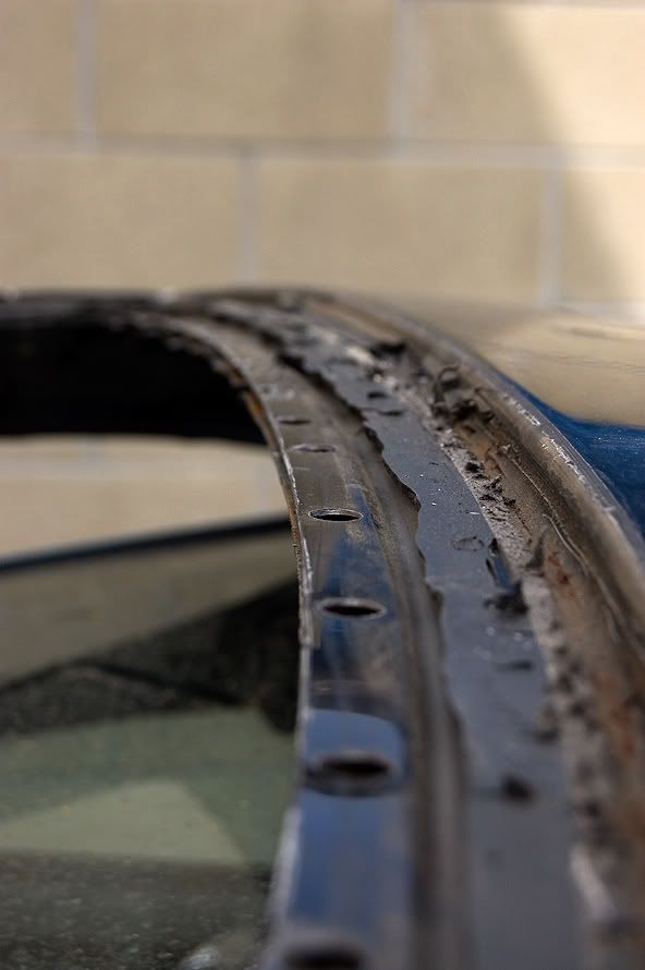

So these are really all the tools that you will need to de-skin the glasstop...Some chisels, blades to clean off the glass gunk and center punches for the Blair Spot well bit...
You have to start by removing all the gunk left from the glass or else you will have hard time finding the spot welds!
Once you found your welds and Center punched each one, you can then go to town with the spot weld remover! I love this Bit!! I will make your life so much easier!!

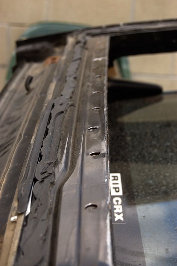

Once you have them all drilled out on the front you can take you chisel and start separating the top skin from the rest of the roof!
Once you somewhat get the front started, start separating the sides with the chisel from the inside!
Go all the way around...

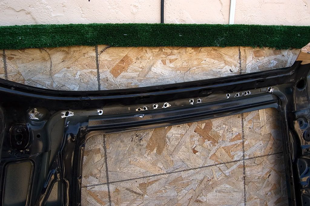

Once I had that all lose I started drilling out the spot welds in the rear and that's when I got a little to anxious with the drill and broke the main bit! :(
So no more spot drilling for me today!

Alright so Leo came over this morning to give me a ride to pick up a new drill bit which I did...once we got home we started working on the roof again and we were able to get the rear spot welds removed, and next thing I knew I had the top skin off the old top!
I gave Leo the honors of separating the skin from the roof! :lolslap:
What you are left with!

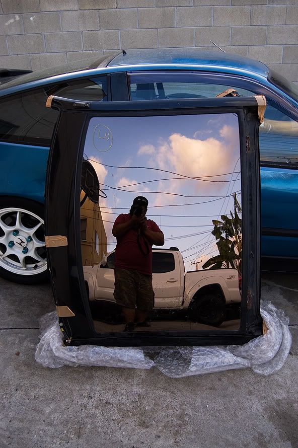

So I finally got my hands on a angle grinder with a cutting wheel, and went to town on the car! My friend Jose and I had the top off pretty quick!
And here is the typical "I just cut the roof off of my car and I am standing in the middle" picutre!
So tomorrow I will be cutting and grinding some more so that we can get the top to fit as perfect as possible...So Stay Tuned!!!
